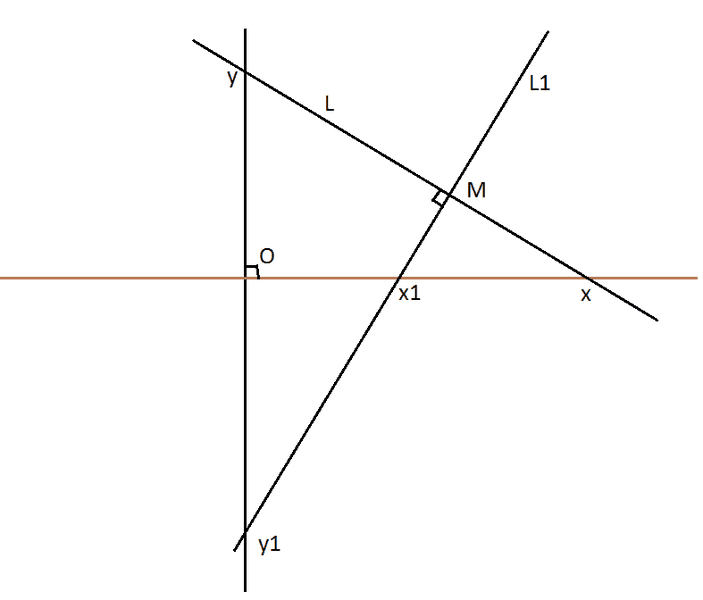

I think he meant: explain the cause of the result
we have 2 perpendicular lines l and l1. the slope of l = -y/x and the slope of l1 = y1/x1
triangle (O,x1,y1) is similar to triangle (M,x1,x) (two angles are the same)
This triangle is also similar to triangle (O, y, x)
therefore y/x = x1/y1 and if you substitute that in the slope of l1, you'll see it's equal to x/y, so the product of the two slopes = -1
