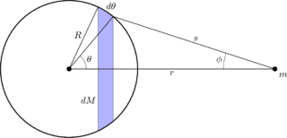

I am concerned regarding a lemma of the shell theorem. Specifically, I am concerned with the idea that due to the vector nature of the forces, that one can simplify this:
into this:
Could somebody precisely explain why we're allowed to multiply in the [itex]\cos \varphi[/itex] in the second equation?
It's a dot product with the radius unit vector. You're projecting the contribution of dF (which I'm inferring is along s) along the radius vector r
