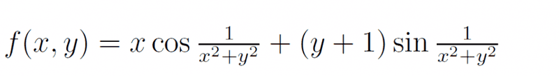

I have to show that the following function does not have a limit as (x,y) approaches (0,0)
I tried taking different paths for example y=x or y=0 and switching to polar coordinates, but I don't get anywhere.
Consider approaching the origin along the line [itex]x = 0[/itex].
Right so the first term cancels and I am left with: y sin ( 1/ y2 ) + sin ( 1 / y2 ) .
So what do I conclude by taking the limit of this?
y sin ( 1/ y2 ) vanishes since y goes to 0. I am a bit confused on what to do with sin ( 1/y2).
Can I claim that limit doesn't exist because sin ( 1/ y2 ) alternates as y goes to zero and therefore doesn't have unique answer ?

Would it be okay to take sequence an = √2/√nπ . Then this sequence obviously converges to zero as n goes to infinity. But f(an) alternates between 1,0,-1,0,...

Simply speaking, we choose epsilon=0.9, we cannot get a corresponding delta to satisfy the epsilon-delta definition of limit.
