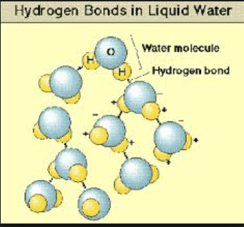

OmCheeto said:
Does this new doodle convey what you two are saying?
I think it does. You added flow, which is convection ie hot fluid rises, so there's mixing.
Maybe we think of 'boiling' in not the same sense..
I think of water as highly polar molecules. The O at one end hogs the electrons so you might think of individual molecules as little electric dipoles, minus at the O end and plus out at the H's.. They're attracted to one another (almost like static electricity attracts a plastic dry cleaner's bag to your arm) hence water's remarkable surface tension and latent heat of vaporization.
http://www.aquadyntech.com/watermolecule.html
Boiling to me means pushing the molecules apart from one another, overcoming those attractive electrostatic forces labelled 'Hydrogen Bonds' between molecules.
That's energy that doesn't show up as temperature, it's a different form of internal energy. Remember temperature is related to kinetic energy of the molecules ie velocity. see http://hyperphysics.phy-astr.gsu.edu/hbase/Kinetic/kintem.html
Of course when a group of water molecules have separated you now have a steam bubble that's a lot less dense so it'll float.
When it's violent enough to see motion we describe that as "Boiling" (or perhaps "Roiling" ).
But to my alleged brain, boiling commences at the molecular level well before we see it.
Ahh, terminology. You'll love taking Thermodynamics.
Does that help any ?
