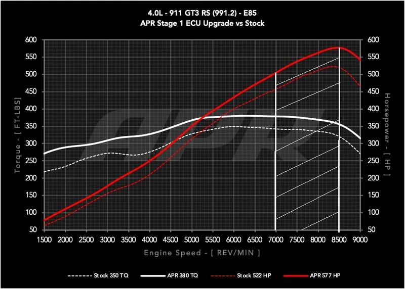

Dale said:
Not on average, no.
When we talk about average power/torque/force, if I want to find average power under power curve in some rpm interval, I need to calculate area under that part of curve(integral) and divide by interval?
Yes, but sometimes there are shortcuts.
