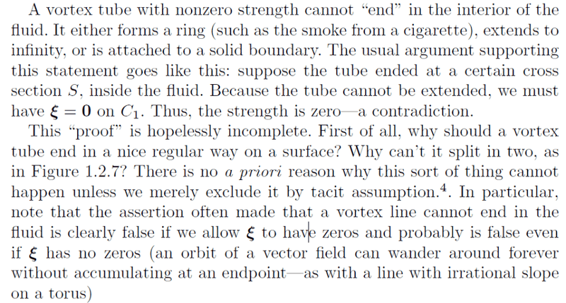

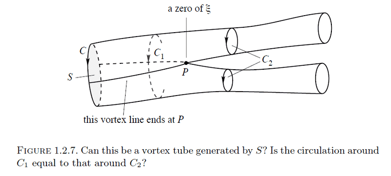

The discussion centers on the properties of irrotational vortices, specifically addressing why circulation is zero for contours not enclosing the vortex axis and why vortex tubes must close on themselves or terminate at fluid boundaries. It is established that for an irrotational vortex, the circulation along any closed contour that does not enclose the vortex axis is zero, while it has a fixed value, ##\Gamma##, for contours that do enclose the axis. This behavior is explained through Helmholtz's Second Theorem and the mathematical representation of the flow field, which indicates that the curl of the velocity field is zero everywhere except along the vortex axis.
