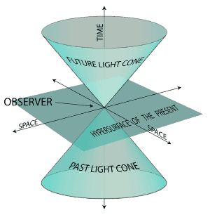

Look at this pic:
We're the Observer but why are all events that occur outside of our past and future light cone limited to the present position of the observer?
They aren't; that diagram is somewhat confusing.
Suppose that we the observer uttered the word "now!" right at that point in the middle where the tips of the cones touch. The horizontal plane is all of the events that we will say happened at the same time that we said "now!", meaning that if they happened ten light-seconds away the light from them will reach the observer ten seconds after he said "now!", if they happened 20 light-seconds away the light from them will reach the observer 20 seconds after he said "now!", and so forth.
However, nothing requires that all the events outside of the two lightcones lie in that plane, and indeed they don't. Our observer will say that everything above that plane happened after he said "Now!" and everything below it happened before. However, for the events outside the past and future light cones other observers in motion relative to our observer will not necessarily agree about whether they happened before or after he said "now!". Only for events in the past and future light cones will observers agree about the relative ordering.

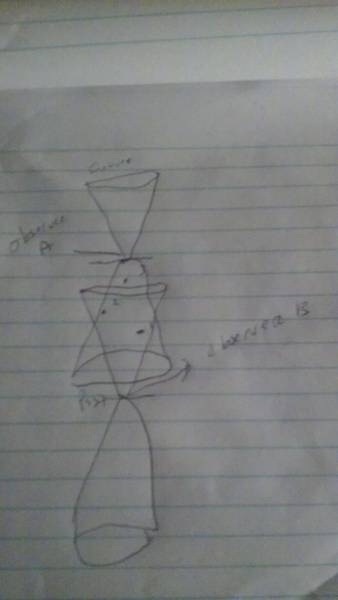

I understand this and I agree with what you're saying but I'm pointing out that the assassination of JFK hasn't occurred for observer B yet so it's in the past light cone of observer A but the future light cone of observer B.
Why would observer B's future light cone be limited to only the events observer A experienced?
There isn't any mechanism I have seen in the laws of physics that binds observer B to observer A's past light cone. Are you saying there's no free will? Isn't that at odds with things like the Free Will Theorem of Conway and Kochen?
If observer B was a friend of Lee Harvey Oswald, are you saying he would have no choice but to allow Oswald to assassinate Kennedy? What force in the laws of physics would stop observer B from stopping Oswald?

Draw that spacetime diagram, include the worldlines of A and B, and mark the events where they each say "Now!" to establish the past and future and lightcones that we're talking about. How are the two "Now!" events related?
The two "Now" events are only related because they share the same past with Kennedy elected and the Cuban missle crisis.
Kennedy's assassination is in the future light cone of observer B. There's no way this can be fixed unless there's some unknown force like in 11.22.63 with James Franco.
This is what nobody is providing. A physical mechanism that says observer B has to see and experience what observer A saw.
PeterDonis says
then B will never see Kennedy being assassinated--but he will never see Kennedy not being assassinated either. He will never see any light signals at all from Earth from the period of time (November 1963) in which Kennedy either was or was not assassinated. So he simply never gets any information at all about such events.
I have never heard or seen anything like this. So observer B sees Kennedy elected and the Cuban Missle crisis but then everything goes dark and Earth vanishes? How can anything that happens in that region of space be unknown to him when he's already experiencing events from that region of space?
Again, Kennedy's assassination is a future event for observer B. His now doesn't contain a past where Kennedy was assassinated. Why does it matter if observer B gets any information from a future event when observer B is occupying his own now? Why does his now depend on information from a future event that hasn't occurred yet for observer B?
Observer B is causally disconnected from events in observer A's worldline.So events in observer A's future light cone can't be the cause of events in observer B's future light cone.
A separate worldline would have to branch at Kennedy's assassination for observer B. Information from observer A's future light cone would have to travel faster than light to be causally connected to observer B's future light cone.

In other words, those events, which I'll label L and M, are both in the past light cones of both "Now" events, which I'll label N1 and N2. Ok.
At which event? What point in spacetime are you thinking observer B is at? Draw it on the diagram.
Ok, so he's at some event, call it B, in the future light cones of L and M--which, since M is in the future light cone of L, means "B is in the future light cone of L" is sufficient.
You have also said that Kennedy's assassination, which I called event K, is in the future light cone of event B. Ok. That means event B is in the past light cone of event K.
Now consider the event at which A observes light from event K, which I called event O. Event K is in the past light cone of event O, and event B is in the past light cone of event K. Therefore event B is in the past light cone of event O. Therefore, at event O, observer A will already have seen observer B, and any causal effect that observer B had on event K will already have been seen by observer A. So, since observer A at event O sees Kennedy assassinated, anything observer B did must have been consistent with Kennedy being assassinated. So whatever "reality" observer B is in, it is consistent with Kennedy being assassinated.

Here's the image:
It's plain to see how Observer B isn't bound to the light cone of observer A.
This was a quick sketch so let me explain.
1. JFK elected
2. Cuban missle crisis
3. JFK assassination
As you can see from the diagram, the light cones for observer A and observer B overlap. They can share the same events 1 and 2 but event 3 can change for observer B because the event (JFK assassination) is in observer A's past light cone but not observer B's future light cone.
So Kennedy gets to Love Field around 11:30-35 CST. Let's say at 11:32 Jackie falls down the last couple of steps coming down the plane and hurts her arm. JFK decides to skip the motorcade and go with Jackie to the Hospital. So in observer B's worldline, JFK is never assassinated.
Observer B isn't limited to events in observer A's past light cone. There's no reason or mechanism in the laws of physics that prohibits observer B from experiencing a different worldline than observer A.
There are a few problems with your diagram as described. First, light cones extend to infinity. They're often truncated in diagrams because drawing infinitely long lines gets boring. But in reality they do extend to infinity - so all the events are in the lower future light cone.
Second, you are confusing observers and events. What you've labelled observer B is actually observer B at a particular time. Since that time is before events 1, 2 and 3, and placed so that they are in the future light cone, observer B at that time could have affected those events. Observer A may have been able to affect the events too. We don't know, because you've also only given us A's position at a particular time, which happens to be after he was aware of all the events having happened.
He doesn't even have to see these events in the same order.
Yes, he does. The events are timelike separated so all observers agree on their order.
It's probably just an accident of having drawn the diagram quickly, but your diagram shows Kennedy having moved faster than light - the slope of a line between events 1 and 2 is less than the slope of a line representing the path of a light beam emitted at event 1.
This will matter when you get to the next step: drawing the worldlines of observers A and B so you can see where they were (what was their now) at the moment that the other one said "now!".
