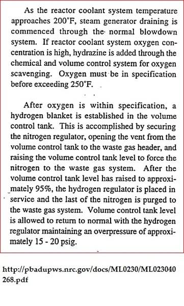

jim hardy Science Advisor Homework Helper Dearly Missed Messages 9,864 Reaction score 4,896 Dec 11, 2016 #3 From the old Westinghouse PWR Technology Manual: http://pbadupws.nrc.gov/docs/ML0230/ML023040268.pdf page 4
