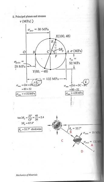

Why is Mohr's circle labeled clockwise and not anticlockwise?
chetzread
798

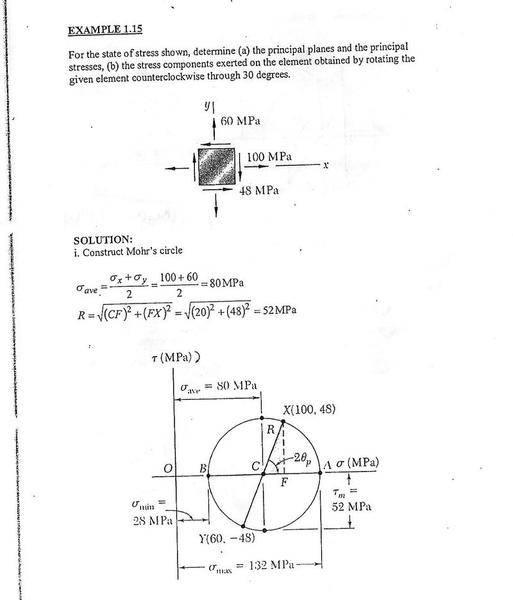

a.)why the angle θ p is in clockwise direction? why shouldn't it be in anticlockwise direction?
b.) I have labelled A,B ,C and D...Why the maximum normal stress is labelled at location A? while the min stress is labelled at location B?
Can I label the min and max stress at other location? Say, max stress a t C , min stress at D? I don't understand why the the author label the max and min stress in that way...
Solution to Example 1.15 showing a stress element with 60 MPa, 100 MPa and 48 MPa, a Mohr's circle with center at 80 MPa, radius 52 MPa, points X(100, 48) and Y(60, -48), and labels for sigma max 132 MPa and sigma min 28 MPa.
Mohr's circle for principal stresses with centre C, points X(100, 48) and Y(60, -48) on the circle, sigma_ave = 80 MPa, sigma_min = 28 MPa, sigma_max = 132 MPa, and angle 2theta_p = 67.4 degrees; below, a rotated stress element showing theta_p = 33.7 degrees clockwise with labels A, B, C, D.
