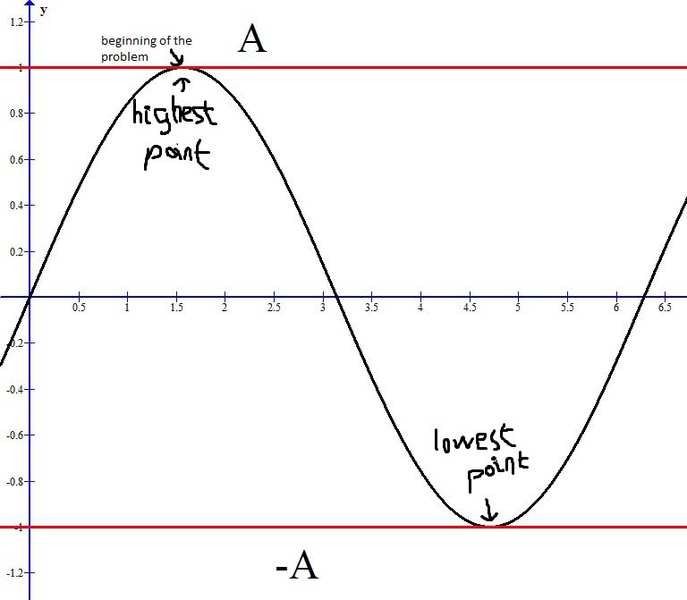

I think I am missing something. I thought A was mesured from the center to one of the extremities on the x(t) graph like on this picture. So from A to 0
Yes, but at the top of the motion, the problem specifically says the spring is unstretched. Thus, at the bottom, it will be stretched by 2A. Starting from the beginning, the spring is unstretched at y = A. At y = 0, the gravitational force matches the spring force. This is the equilibrium point. Finally, y = -A is the lowest position of the object. You are getting confused because the position where the spring is unstretched and the equilibrium position of the oscillation are not at the same place.
Exactly. So the amount that the spring is stretched is 2A, since it starts out at the top with zero stretch.
