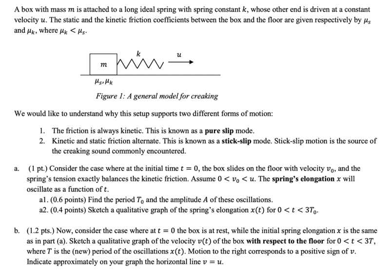

Please see the attached photo
**I am only asking about the answer to part B, but please reading through part a may give some some context/familiarity.**
No equations required, but understanding SHM and Forces is important
I am only asking about the answer to part B, but reading through part A may give some some context/familiarity.

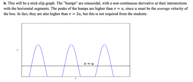

Below is the answer to part B:
I largely understand the graph except for 1 part. My understanding is as such:
At first, ##x = \frac {\mu_k m g } {k}##. Force exerted by the extending spring is not enough to overcome the static friction.
Ater some time, force exerted is enough to overcome the static friction, resulting in velocity increasing.
However, the spring is still extending, because velocity of pulling > velocity of block.
When ##v = u##, maximum extension has been reached, maximum rightwards force on block.
At ##v = V_{max}##, ##\mu_k mg = kx##. After which, the net force on the block slows it down.
At ##v = u## again, the block has been slowed to speed ##u##, at which point no further compression can occur. (ie max compression)
Block is now pushed leftwards and slows down.
My question:
Why must the block slow down to speed 0, at which point static friction stops it from moving anymore? The point this occurs is when the spring is still compressed.
I am hoping to get a physical explanation of why the forces on the block slow it down to 0 velocity when the spring's compression ##= \frac {\mu_s m g } {k}##. I do not find the "symmetrical graph" argument convincing enough.

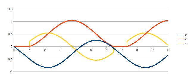

Sorry for the delay.
I remained a bit bothered by this question so I simulated it, and it took a bit of effort to get the formulae right.
In the graph, the blue is the extension, measured positive in the direction of the pulling force, so tension is negative. Red is ##\dot x## and yellow is ##\ddot x##.
So at the start, the blue line is straight and acceleration zero until there's enough tension to overcome static friction. The acceleration jumps up because friction immediately reduces to the kinetic value.
Note that the horizontal sections of the red line (i.e. where it sticks) are well below the half way. This is rather different from the chart in post #1. I think it makes sense: the velocity must take a little while to catch up to the puller's velocity, and acceleration will continue to increase for that time.
But what intrigues me is that the curves are not quite symmetric. If you look carefully you will see that for the acceleration the jumps up from zero (e.g. t=1) are a bit smaller than the jumps up to zero (e.g. t=6.4).
Correspondingly, the velocity curve rises more slowly from zero than it later falls to zero.
I have no explanation for this yet. At first I thought it must be rounding error in the spreadsheet steps, but no matter how small I made the time steps it persisted.
Time to get back to the algebra.

This has been extremely helpful! Thanks so much. The velocity graph you’ve derived also resolves another issue I had with the answer key’s graph; the gradient (acceleration) is not maximum when v = u.
I didn't say how I had the constants set. In that chart I had u=0.5, which is the value of v at max acceleration.
