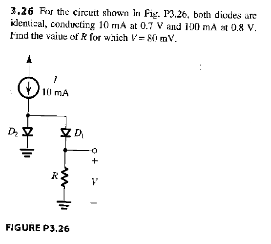

I=Ise(V/VT)
The solution I got is wrong. Does anyone know why?
Here is my attempt, the image was too large for this forum so here is the link:
http://i.imgur.com/4tuGxdO.jpg
You ignored VT in the exponent.
ehild
Isn't the VT value the same (approximately 0.025V at room temperature)?
The approximation is just that, an approximation. It is a good "typical" value for run-of-the-mill diodes. The actual value for a given diode depends upon the details of the diode doping. You should determine its true value for this problem.
Even in case it is, I1/I2 = e(V1-V2)/VT
ehild
You may need to run a few simultaneous equations. Here's my suggestion: Use the generic information provided to solve for Is and VT before proceeding further. Then from there you can solve for R using the fact that both sides of the circuit must equate 10mA.
