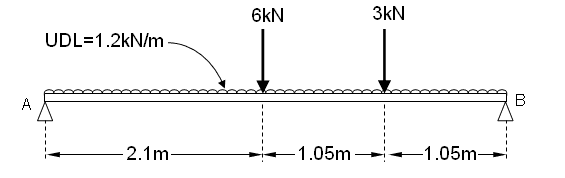

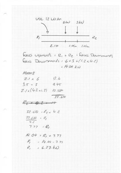

Hi, wondering if any can have a look a the below to see if my working outs are correct.
Thanks.
1. Homework Statement
Determine the two support reactions at positions ‘A’ and ‘B’ for the following simply supported beam which is acted on by a uniformly distributed load (UDL) and two point loads.
Diagram of a simply supported beam with supports A and B at its ends, a UDL of 1.2kN/m over the full length, a 6kN point load and a 3kN point load downward, spans labelled 2.1m, 1.05m and 1.05m.

Handwritten beam working: a simply supported beam with a UDL of 12 kN/m and point loads of 6 kN and 3 kN downward, supports R1 and R2 at the ends, spans 2.1 m, 1.0 m and 1.0 m; below, force and moment equations solving for R1 and R2 on graph paper.
Looks correct to me. A good check is to see if the moments add to zero about a different origin.
