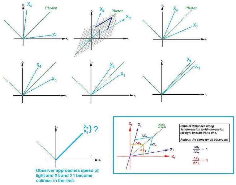

Phil, the above posts are all very good. There is also another complimentary way of looking at this. I've shown a sequence of graphs representing the coordinate systems for observers moving at ever higher speeds with respect to some reference rest system. The pictures include just one of our normal 3-D coordinates, X1, along with the 4th dimension, X4.
These coodinate systems are the way they are in order that nature can provide a universe in which the laws of physics are the same for all observers, regardless at what constant velocity they move relative to some arbitrarily chosen rest system. It is a special set of coordinates to be sure. Notice that angle between the the X4 and X1 coordinates are always bisected by a 45 degree world line in the reference system.
The X4 coordinate rotates clockwise to some angle, consistent with representing the velocity with respect to the rest system. But, the unusual aspect of these systems is that the X1 coordinate is always rotated counterclockwise by the same angle. The other fascinating detail in special relativity (by some interpretations) is that all observers are moving along their own X4 axes at the speed of of light.
But, specifically to your question is the observation that a photon of light moves at a velocity corresponding exactly to the 45 degree world line (the one that bisects the angle between X4 and X1 for all observers)--and as an observer moves faster and faster (as in the sequence of coordinates) the X4 axis and X1 axis keep rotating closer and closer to each other. In the limit they would become colinear--a result that has no physical comprehension in terms of a world that could be experienced by an observer who would then be moving at the speed of light.
The box in the lower right corner shows why the ratio of displacement along the 4th dimension to displacement along the X1 dimension, X4/X1, for a photon moving at speed c is the same for any of the special relativity coordinate systems. The fundamental observation is really that the ratio of the spatial distances is equal to 1.0 for all observers. The speed c comes out as a result of our arbitrarily chosen system of units for time and spatial distance. That, along with the aspect of all observers moving along their X4 dimensions at speed c. Thus, X4 = ct in any of the coordinate systems. Then, the speed of a photon,
X1/X4 = X1/(ct) = 1. Thus, c = X1/t for a photon (in any of the coordinate systems).
That's what makes c so special. It's that 45 degree world line in the spacetime diagrams. And it represents that limiting case of the X4 and X1 axes rotating toward each other--nature has built into the physics a way of avoiding the rotation of X4 and X1 to the point of becoming colinear.
