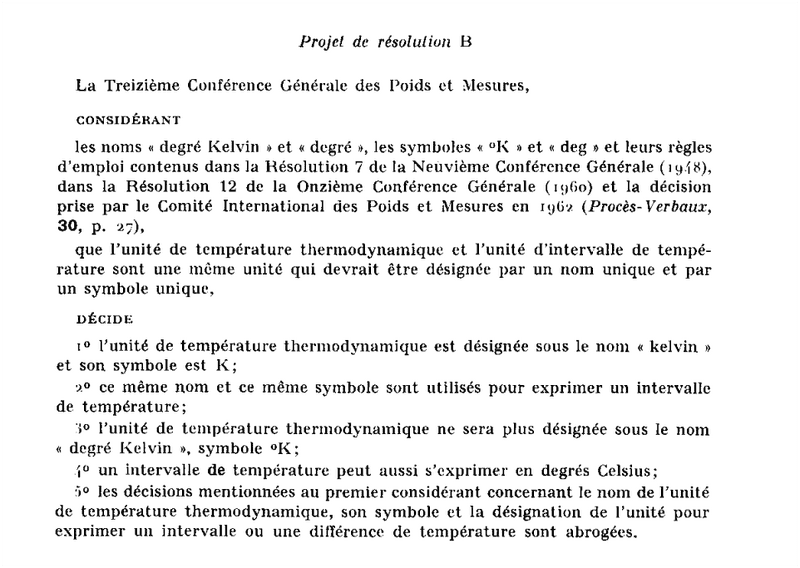

@OmCheeto
Well, I don't speak it fluently, nor English, it's not my native language. I searched for a document in English and couldn't find it.
*Note* I didn't do the translation, I used artificial intelligence.
Draft Resolution B
The Thirteenth General Conference on Weights and Measures,
CONSIDERING
the names "degree Kelvin" and "degree," the symbols "°K" and "deg," and their usage rules contained in Resolution 7 of the Ninth General Conference (1948), in Resolution 12 of the Eleventh General Conference (1960), and the decision made by the International Committee for Weights and Measures in 1962 (Proceedings, 30, p. 27),
that the unit of thermodynamic temperature and the unit of temperature interval are the same unit and should be designated by a unique name and a unique symbol,
DECIDES
  1. The unit of thermodynamic temperature is designated by the name "kelvin," and its symbol is K;
  2. The same name and the same symbol are used to express a temperature interval;
  3. The unit of thermodynamic temperature shall no longer be referred to as "degree Kelvin," symbol °K;
  4. A temperature interval may also be expressed in degrees Celsius;
  5. The decisions mentioned in the first consideration concerning the name of the unit of thermodynamic temperature, its symbol, and the designation of the unit to express an interval or a temperature difference are repealed.
    Proceedings of the 13th CGPM (1967), 1969, p104 (page 19)

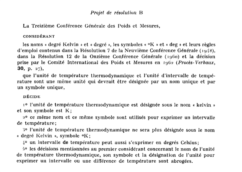

OMAR_ALQAM said:
@OmCheeto
Draft Resolution B
CONSIDERING
DECIDES
Does that solve your question? (You translated the draft of the resolution, but the final resolution is in page 104, other important discussions can be found in pp. 64-66).
I didn't know there were discussions on the subject in the file! I barely knew where they were talking about the Kelvin unit (the file is in French) and I saw the results and their translation.
Thank you for alerting me 😊@pines-demon
pines-demon said:
The whole issue seems to be that some people wanted degrees to mean temperature intervals, so °C means degrees with respect to 0°C. However for simplicity they decided on having a single symbol for SI for both temperature intervals and absolute temperatures given by K (note that we do not have a different symbol for "mass intervals"). However degrees °C is still authorized. Before the resolution you could find some documents that used °K for temperature differences.
An interval scale means both more and less than what you wrote. It does not mean "with respect to 0 °C". An interval scale instead means that the ten degree change from -5 °C to +5 °C has the same meaning as does the ten degree change from 10 °C to 20 °C. The zero point is arbitrary in an interval scale. The meaning of the intervals is anything but arbitrary. That intervals are consistent means that one can (for example) compute the arithmetic mean of a collection of temperature samples. However, computing the geometric mean is not possible. That would require that temperatures be able to undergo multiplication as well as addition.
The reason we do not have a different symbol for "mass intervals" and "mass" is that (at least until relativity and quantum mechanics came along) was that we had a fairly good idea of what "mass" was. If mass was like temperature (degrees Celsius or degrees Fahrenheit), we would have the zero point of mass being something like the mass of a long-dead king. But we don't use the mass of a long-dead king as the zero point of mass. People everywhere (except perhaps merchants with intentionally bad scales) have long measured mass on an absolute scale that is also a ratio scale. Zero mass has real meaning.
That it is also a ratio scale means that things like doubling the mass or the ratio of two masses or the product of two masses makes sense. In comparison, doubling a temperature expressed in degrees Celsius or the ratio or product of two temperatures with both expressed in degrees Celsius does not make sense. In an interval scale (but not absolute scale) such as degrees Celsius, the difference between two temperatures does make sense, as does the ratio or product of a pair of temperature difference.
That was the point behind eliminating the degree symbol from the Kelvin scale. On the Kelvin scale, there is no difference between temperature and temperature difference. They are the same thing. Values on an interval scale can be added or subtracted, but cannot be multiplied or divided. An absolute scale is a different kind of scale than is a non-absolute scale.
