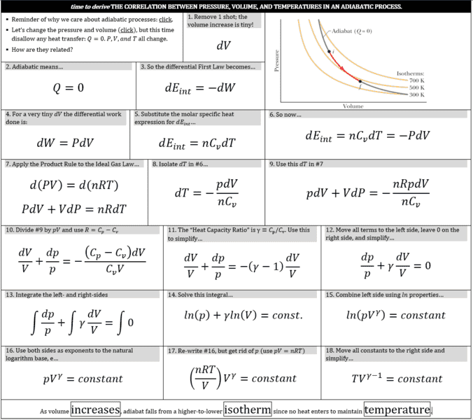

Here's a derivation of the adiabatic PVT relationships.
QUESTION: When solving adiabatic PVT homework problems I found that I needed to express temperature in Kelvin, rather than Celsius, to get the right answers. Where in this derivation should this be specified, and how should it be specified - or otherwise how should I know this?

My hunch is that the Ideal Gas Law is based on absolute temperature, which is the basis for all of this.
This is a fundamental concept in thermodynamics which I think you should have learned at the very beginning of any course. Temperature in a gas is a measure of the average kinetic energy of the molecules in the gas. This only goes to zero at absolute zero, so all of these expressions in thermodynamics only make sense when using an absolute temperature scale. The zero point of the Celsius scale is arbitrarily set at the freezing point of water. This zero point has no relation to the thermodynamic quantities.
