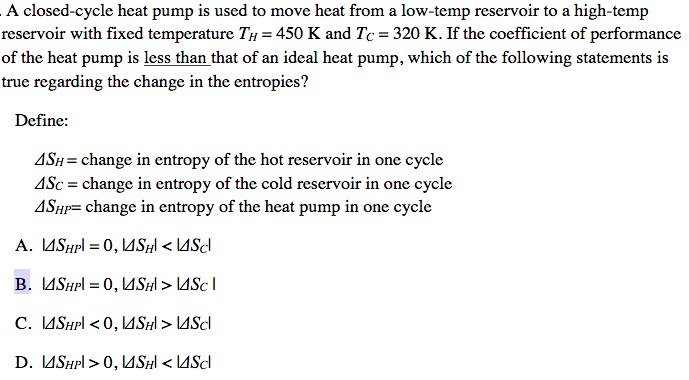

A closed-cycle heat pump is used to move heat from a low-temp reservoir to a high-temp reservoir with fixed temperatureTH= 450 K andTC= 320 K. If the coefficient of performance of the heat pump is less thanthat of an ideal heat pump, which of the following statements is true regarding the change in the entropies? (see image attached)
S always >= 0, where S=0 only in ideal case.
for hot reservoir, delta S = negative
for cold reservoir, deta S = positive
as it is not ideal,
total change of entropy > 0
entropy loss of hot reservoir > entropy gain of cold reservoir
why would the change in entropy of the heat pump in one cycle equals to zero?
The hot reservoir does not experience an entropy loss. It receives heat in this process, so its entropy increases. And the cold reservoir does no experience an entropy gain. It loses heat in this process, so its entropy decreases.

No. The entropy gain of the hot reservoir is greater than the entropy loss of the cold reservoir.
The entropy of the heat pump (i.e., the working fluid) is zero for a cycle because entropy is a physical property of the working fluid (i.e., the state of the working fluid), and, in a cycle, the working fluid returns to its original state after each cycle.

With a heat pump, you are removing heat from a cold reservoir and adding a greater amount of heat to a hot reservoir. That is what a heat pump does.

No. They don’t experience a cycle. Typically, you are taking heat from outside air (the cold reservoir), adding work, and pumping heat into the house air (the hot reservoir).

The sum of the two is greater than zero.

Like I said, the sum of the changes has to be greater than zero.

So do you mean with 2nd law of thermodynamics, the entropy gain always greater than entropy loss, no matter it is heat engine (hot reservoir gain>cold reservoir loss) or heat pump (hot reservoir loss<cold reservoir gain)?
Yes, for an irreversible engine, there is overall entropy generation.
