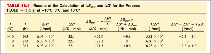

This is the given table. I first assumed that the temperatures indicated where those of the surroundings and assumed that the the mole of ice was at 0 degrees celsius, and this would be quite logical, because in this case ΔSuniv would give a measure of the driving force in this process and would tell us that at 10 degrees celsius, ice cubes melt faster than, say at 1 degree Celsius. But then in the formula for ΔG, isn't the temperature T, the temperature of the system, and in ΔSsurr isn't T the temperature of the surroundings*. So I suppose the correct assumption is that Tsystem=Tsurroundings. And we are given successively an ice cube ( 1mole) at -10 degrees C in a -10 degrees C environment, and then at 0 and 10 degrees C.
*For this I am not so sure because for it not to have a subscript, T must designate the temperature of the system, and in this case we have no idea about T surroundings

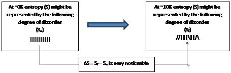

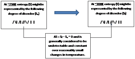

One consideration is that temperature in ∆H =T∆S is a ‘positional temperature’ chosen by the observer. At very low temperatures close to 0 Kelvin, ‘changes’ in entropy ( say +10K) are very noticeable, but at much higher temperatures around 25oC (298 K) ± 10oC/K, ‘changes’ in entropy are, for practical purposes, undetectable and considered constant and temperature independent. Consider the following hypothetical:
Remember ‘Entropy (S)’ is a measure of disorder relative to zero Kelvin typically showing a positive value, whereas ∆S is a change in Entropy [∆SoRxn = Σn·So(products) - Σn·So(reactants)] of the system and can be either positive or negative depending upon the reaction system being considered.
During phase change Ice => Water the system temperature is constant (see heating curve of ice => water => steam), so the reference -10 to 0 to +10 degrees would refer to the temperature values of the surroundings chosen by the observer to examine the effect that such choices have on the system.

I think that I finally made some sense out of the table in post #2 that may be helpful to you. The columns involving the surroundings seem superfluous to the entire situation, since, in the end, we are interested in determining the change in free energy of the system. So we should be focusing primarily on the system. And, since free energy is a function of state, we only need to know the initial and final states of the system. However, since you do have some interest in what is implied for the surroundings in this table, let's talk a little about that.
The row in the table labeled -10 C refers to the following irreversible process:
Initial State: One mole of Ice at -10 C
Final State: One mole of liquid water at -10C
In this change, it is assumed that the surroundings is being held at -10 C throughout the change because it is being modeled as an ideal infinite reservoir at -10 C throughout. During this change, the average temperature within the system may not be constant, and may drop below -10C temporarily, but in the end, it is again at -10 C. So there can be temperature gradients within the ice/water during the change. However, at the interface with the surroundings (ideal reservoir), the temperature remains -10C. This is how there is a heat transfer driving force within the system during the change. But, because the reservoir is ideal, its entropy change is Q/263, where 263 is both the temperature throughout the surroundings/reservoir and the temperature of the system at the interface with the reservoir.
The change in free energy of the system (the ice/water) at -10 C for the initial and final states described above can be properly determined in either of three ways. The first way is to make use of the equation:
$$\frac{d(ΔG/T)}{d(1/T)}=ΔH$$
So,$$\frac{ΔG(263)}{263}-\frac{ΔG(273)}{273}=ΔH\left(\frac{1}{263}-\frac{1}{273}\right)$$
But ΔG(273) = 0
Therefore, $$ΔG(263)=\frac{10ΔH}{273}=+221\, J/mole$$
Similarly, $$ΔG(283)=-\frac{10ΔH}{273}=-221\, J/mole$$

So $$d(ΔG)=-ΔSdT$$
where the Δ's refer to the change from ice to liquid.
So, $$ΔG(263)-ΔG(273)=(-ΔS)(-10)$$
So, $$ΔG(263)=+10ΔS=+221\, J/mole$$
The third way is simply to write ##ΔG(263)=ΔH-263ΔS=+221\, J/mole##
It still doesn't make sense to me how they arrived at the changes in free energy in the table using the change in entropy of the surroundings, or why invoking the surroundings was even necessary.
Chet
James Pelezo said:
Let’s try this … Go back to the table at the beginning of this thread and note the ∆G values and (yes) let ‘T’ be the system temperatures -10oC =>∆G = +220 J/mol, 0.0oC => ∆G = 0.00 J/mol and +10ooC =>∆G = -220 J/mol. What I’m interpreting the table to say is if T(system) = -10oC and ∆G = +220 J/mol., there is very little tendency toward spontaneous phase change because ∆G >> 0.00 J/mole; if T(system) = 0.0oC and ∆G = 0.00 J/mol., phase change is spontaneous and occurring at a thermodynamic equilibrium with constant temperature of both system and surroundings (which, in this case = 0.00o C) and if T(system) = +10oC and ∆G = -220 J/mol, the tendency toward phase change would be (hypothetically) 220 times more probable than at 0.00oC and 440 times more probable than at -10oC and would be an indication of the driving force present to initiate and sustain the phase change. Just a different way of looking at the problem as it relates to giving the system the temperature values defined in the table, but it sure seems more plausible to relate the temperature to surroundings that would be influencing the phase change tendency.
Hi James,
I like your development quite a bit. I have something additional that I think you may find interesting.
Let G(T,P*) represent the free energy of water vapor at temperature T and pressure P*, where P* is the vapor pressure at the triple point. Then the free energy of water vapor at temperature T and pressure ##P_{liq}##, where ##P_{liq}(T)## is the equilibrium vapor pressure of liquid water at temperature T, is given by:
$$G(T,P_{liq}(T))=G(T,P^*)+RT\ln{(P_{liq}(T)/P^*)}\tag{1}$$
Similarly, for water vapor at temperature T and pressure ##P_{ice}(T)##, where ##P_{ice}(T)## is the equilibrium vapor pressure of water ice at temperature T,
$$G(T,P_{ice}(T))=G(T,P^*)+RT\ln{(P_{ice}(T)/P^*)}\tag{2}$$
At temperatures above 0 C, Eqn. 2 will involve extrapolation of the ice vapor pressure behavior, while, at temperatures below 0 C, Eqn. 1 will involve extrapolation of liquid water vapor pressure behavior (say, in either case using the Clausius Clapeyron equation).
Since, at saturation, the free energy of liquid water and water ice will be equal to that of the corresponding saturated vapor, we can write $$G_{liq}(T,P)=G(T,P^*)+RT\ln{(P_{liq}(T)/P^*)}+V_{liq}(P-P_{liq}(T)\tag{3}$$
and $$G_{ice}(T,P)=G(T,P^*)+RT\ln{(P_{ice}(T)/P^*)}+V_{ice}(P-P_{ice}(T)\tag{4}$$
where the V's are the specific volumes of water and ice and P is the total pressure on the ice and liquid water system. So the change in free energy between ice and water at any given temperature and pressure P is given by:
$$ΔG=RT\ln{(P_{liq}(T)/P_{ice}(T))}+V_{liq}(P-P_{liq}(T)-V_{ice}(P-P_{ice}(T)\tag{5}$$
Typically, the terms involving the specific volumes are going to largely cancel, and the equation, to an excellent approximation in our region, can be reduced to:
$$ΔG=RT\ln{(P_{liq}(T)/P_{ice}(T))}\tag{6}$$
So we can not write:
$$\ln{(P_{liq}(T)/P_{ice}(T))}=\frac{ΔG}{RT}\tag{7}$$
At 263 K, ΔG=221 J/mole, and this equation predicts that,
$$P_{liq}(263)/P_{ice}(263)=1.11$$
At 283 K, ΔG=-221 J/mole, and this equation predicts that,
$$P_{liq}(283)/P_{ice}(283)=0.911$$
So, at -10 C, if liquid water, ice, and water vapor are in contact, there is an identifiable pressure driving force for liquid water to form ice. And, at +10 C, if liquid water, ice, and water vapor are in contact, there is an identifiable pressure driving force for the ice to form liquid water. Actually, of course, the water vapor does not even have to be present for this same driving force to exist.
Hope you find this interesting.
Chet
