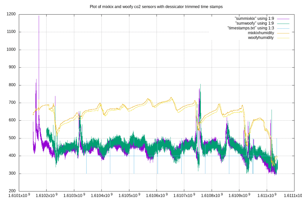

The difference in humidity inside versus humidity outside might be causing the difference in your CO2 values. mixkixandwoofyco2andhumiditytrimmedtimestamps.png
I was recently trying to set up a Cozir CO2 sensor outdoors on a 12 foot pole. I had two of these pole devices, For weeks of tests at a time, the data returned was displeasing. I took the sensors off of the poles, and put them in 2" diameter 3/4" high plastic containers. I made a moisture absorber with a 1 pint screw lid canning jar, a small sample pump, with 1/4" copper tubing inlets and outlets hot glued to the plastic containers and the jar. The moisture absorbent is silica gel from a craft supplies store (Joanne crafts).
With the humidity absorbing device inline, the two CO2 sensors (now on my workbench, not outdoors) show steady consistent values. . What I am trying to build is several remote CO2 meters to estimate local CO2 emissions. The sample pump came from Excess Solutions and Halted Electronic Supply, San Jose. CA
