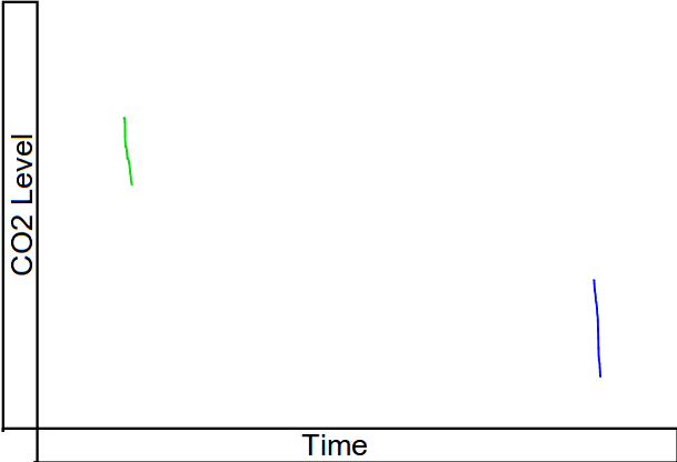

Have looked more closely at your numbers.
There are two time separated sets of closely clustered points, at two different locations.
The first (based on the time stamp) set (outside) has a smaller downward (wrt time) slope (-0.688 ppm/s)
than the second set (inside; -1.277 ppm/s).
They both slope down.
The period between the readings (2658 s) is too large account for the overall differences inside/outside just based on either of the slopes, but it is in the same temporal direction.
I suspect something instrumental.

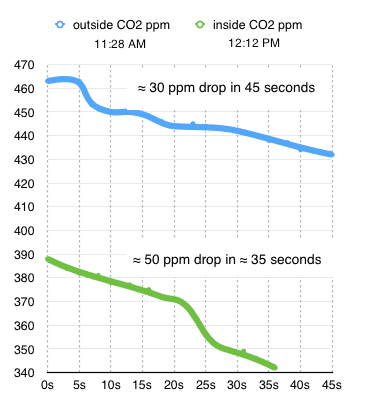

Is this a leave it on all the time type meter or a turn it on and use it for spot checks kind of meter?
I've never owned nor operated a CO2 device, but the rapidity with which the CO2 levels dropped, and the sequence of the readings, indicates that your batteries might need changing.
Just a guess, of course.

Do one continuous ABAB test: Inside for one hour, outside for one hour, inside, outside. ABAB tests are good for separating sensor drift from actual reading changes.
The datasheet states a 20 second time constant response to a change in ##\rm{CO_2}## concentration, so the test should be long enough for the sensor to stabilize, plus longer to look for concentration fluctuations.

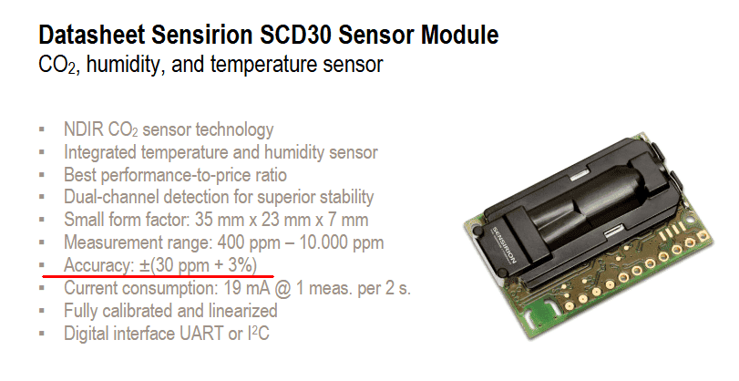

The data sheet specifies: Accuracy: ± (30 ppm + 3%)
It's a bit ambiguous what that means. If I assume the 3% applies to the measured value and not to the error itself I have, at 400ppm, an accuracy of ± (30ppm plus 12ppm), or ± 42ppm. So, an actual value of 400ppm could display as 358 to 442 ppm.
Also, the measurement range starts at 400ppm so values below that are out of spec. The present global CO2 level is about 412ppm so you are unlikely to get external measurements differing much from that.
Never confuse accuracy with resolution!

Before I tell what I believe is happening, let me first say that you need a lot more data. @jrmichler suggested an ABAB measurement pattern. I suggest you collect measurements at a rate of one sample every 30 minutes for 24 hours, then switch between indoors and outdoors. Do this for 4 days so that you have the two examples of the daily pattern each for indoors and outdoors.
Plants consume CO2 in the day and exhale it at night.
Plant "dark respire" all the time - releasing CO2.
They photosynthesize only with light.
https://www.bbc.co.uk/bitesize/guides/zpwmxnb/revision/3
Your samples were taken midday, when the consumption is at its greatest - and thus the CO2 levels are dropping the fastest. You saw them drop while taking the outdoor readings, they continued to drop as you relocated the instrument, and then you saw them continue to drop as you measured them indoors.
Here is a plot of both sets of readings, outdoor (green) and indoor (blue):
Extrapolating, it would appear that had you left the instrument outside, you would have picked up even lower reading that what you got indoors.
I would come to 2 conclusions:
During the time you took these measurement:
1) It was quite sunny; and
2) Your house was ventilated - but not completely open to the outdoors.

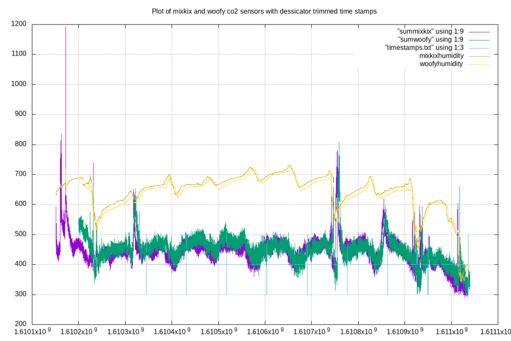

I have owned 4 CO2 meters. Three different manufacturers. 2 units from the same manufacturer provide readings that were different by almost 40%. They insisted that I should recalibrate both units. I did and the results did not change. They accepted return of the so called defective unit and refunded the purchase price
