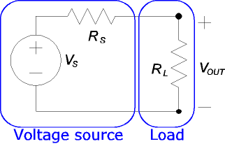

russ_watters said:
-The source supplies a Voltage.
-Based on that voltage, the load demands an Amperage.
-The source supplies that Amperage or dies trying.
from Wiki
in that diagram the resistor in the "load" would be the wire itself (since AFAIK diagrams assume perfect wires with no resistance)
anyways, would that demand of amperage be based on Ohms law? (V=iR) or how is the load demanding amperage from the source?
and if so, wouldn't that be the calculation I did earlier (i=V/R) which is not close to that half a miliamp

So, as you can see in that diagram, if I replaced R_L with 0, then the maximum current is V_s/R_s. If this is a large number, it's possible the resistor R_s just blows and you've just broken the source. Hopefully, the designer of the load put in some sort of fail safe systems to prevent that from happening (by e.g. adding in a fuse that shuts off the system if some amperage is reached).

_Bd_ said:
from Wiki
You calculated it fine earlier. The nameplate voltage is what you apply to V=IR. If the power supply can supply the demanded amperage, everything is fine. If not, something fails. Sometimes circuits fail.
Yep. So you've just calculated that the circuit will fail. The voltage will sag, the amperage will exceed the capacity of the power supply -- probably all that happens is the fuse blows, but there is always the possibility of damaging something.
