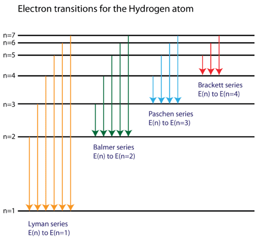

I don’t understand the lines that suppose to come from it. If I have an emission from lvl 4 how many lines would I get?
That electron that has been elevated or excited to level 4 can decay back to its ground state in a variety of ways. It can get there in one hop (lots of energy emitted - ultraviolet, longest line on your graph) or in a series of hops to lower levels. Each hop toward ground state will emit electromagnetic energy the magnitude being determined by the relative energy difference between the levels. Big hops or longer lines on your graphic correspond to higher energy, higher frequency, and lower wavelength emission lines. Smaller hops correspond to lower energy, lower frequency, and longer wavelength emission lines. Your question asks you to determine all the ways this level 4 electron can get back down to ground state and count the pathways. Each pathway will have its own unique emission line.

Yes!thank you ! I was looking for an explanation for hours.:)
