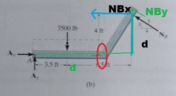

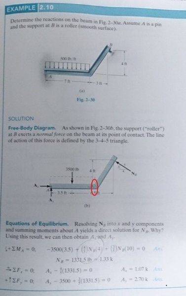

for the moment about A , why there 's moment generated by the forces of 0.8NB (circled part) ?
I think it's not necessary to include the moment 0.8NB(4) because the d = 0.4m is not measured directly from point A ...it's measured from the red circled part ...

1. It's not 0.4 m but 4 feet and it's the vertical distance between B and A
and that is multiplied with the horizontal component of NB
2. the 10 feet is the horizontal distance etc.

In the diagram attached below , we can see that the d (prepedicular distance) for NBy is measured directly from A , but for the NBx ( blue part) , it's measured directly from a point which is 10 m from A . So , for the moment 4NBx , it's not moment about A , am i right ? Why the author consider it in the calculation ?
No. The line of action of NBxis at a perpendicular distance of 4 feet from A
why ?
A force acts along a line of action. You can always move it along that line without changing anything.
Only when you move a force perpendicular to its line of action you have to add a torque.
To reassure yourself: calculate the perpendicular distance of the line of action of NB itself to the point A and compare with the total torque from x and y components.
