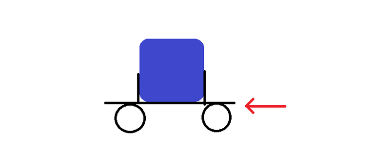

When you put mass on wheel and move it horizontally, aren't there any forces the mass?
Like in this pic.
Like in this pic.View attachment 211698
Depends: is there friction there, such as in the wheels? If there is no friction or other reaction force, what does your applied force do?
There are frictions in the wheel and air friction.
When we walk, we use force to move forward. And we face some friction that slows us down.
When we carry something and walk, won't we then apply forces to what we carry?
How much force do you think those generate? We can make reeally good wheels and bearings...
...and when carrying a piano, you don't even have wheel friction.
How/how much?
We're trying to make you specifically define and better yet quantify the actual forces. I think if you try you will have a hard time defining any relevant forces that can't be arbitrarily close to zero.

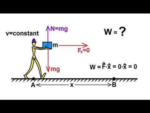

And a person carrying a box on his hand (like in this picture):
Only initially (which is the friction between his hand and the box) is some force and work needed, and after that no more horizontal force is needed keep the box moving forward (if we assume no air drag)?
Yes.
