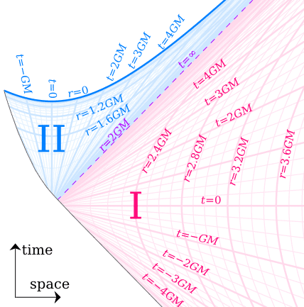

If we cross the horizon of Schwarzschild black hole horizon, we know that r becomes to timelike.
Why the fututre is direction of decreasing r rather than increasing r?

I find that using light cone direction as the future direction, from diagram we can see that future is towards r decreasing.
This is easier to see in a different coordinate system which is not singular at the horizon such as Kruskal–Szekeres coordinates.

This Kruskal–Szekeres diagram from an old post of mine may help:
Pink zone I is outside the event horizon.
The dotted purple line is the event horizon.
Blue zone II is inside the event horizon.
The thick blue line is the singularity.
The curved lines are lines of constant ##r## coordinate.
The straight lines are lines of constant ##t## coordinate.
As you approach the event horizon, upwards in the diagram, ##r## is decreasing. It continues to decrease inside the horizon.
