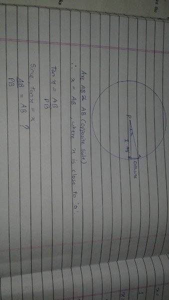

This is the explanation i actually needed. But i want you to extend it a little bit, hopefully you will clear my doubt(please check my attachment). I will appreciate further reply from you :)

The photo you posted is the reason that we discourage images of work.
  1. The image is unreadable because it is so small.
  2. The image is rotated, making it difficult to read even if it were larger.

You left out a PB in the length of the arc. The arc length should be AB = x PB.
In my example, I used a radius of 1, so PB = 1. But you don't have to make that assumption.

Thanks for that
