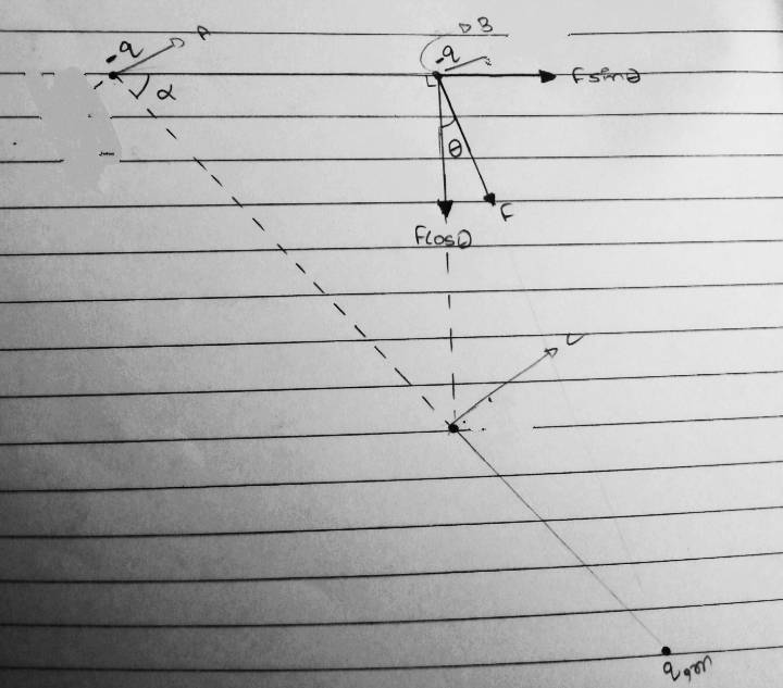

Definition of conservative field I use:-it is a field in which potential energy of system is independent of path taken.
I understand that it is independent because whenever we take some path than all the perpendicular displacements with respect to force are not counted and if we go further than the point for which we are finding potential energy and come back to that point than additional potential energy due to further displacement is canceled by the reverse path and thus energy is conserved.
But I can't understand the case I have posted,
Work done in moving particle from A to C is equal to B to C but I don't know why.
I thought it should be same because force on point at b is more than point at c thus it should but i want to know why work done in both cases are exactly similar.
Edit:- both points are at infinity

Are you moving a negatively charged particle in a uniform electric field? Is the direction of the force on the particle represented by the arrow labeled F in your drawing?
Work from A to C is generally not equal to work from B to C because the starting points are different. Work fro A to C along the straight path is equal to work from A to B plus work from B to C. The end and start points must be the same.

No,I am moving these negative charges in a field created by positively charged particle which I have shown in figure.
Yes,it is force and I also have represented its component in its displacement direction.

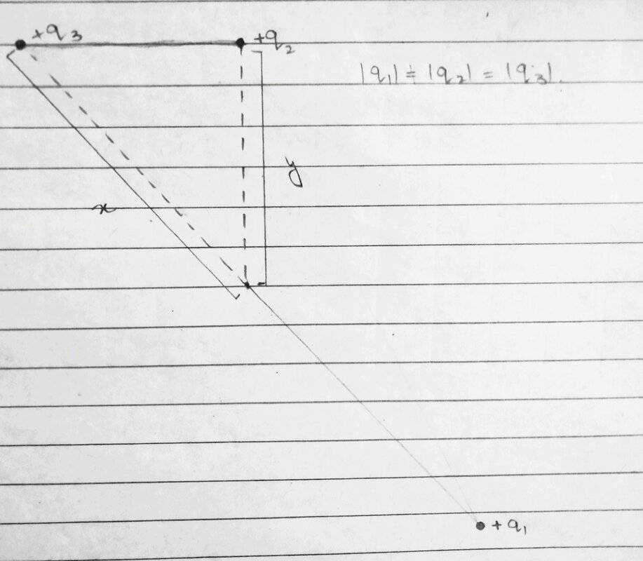

Sorry for erroneous explanation,

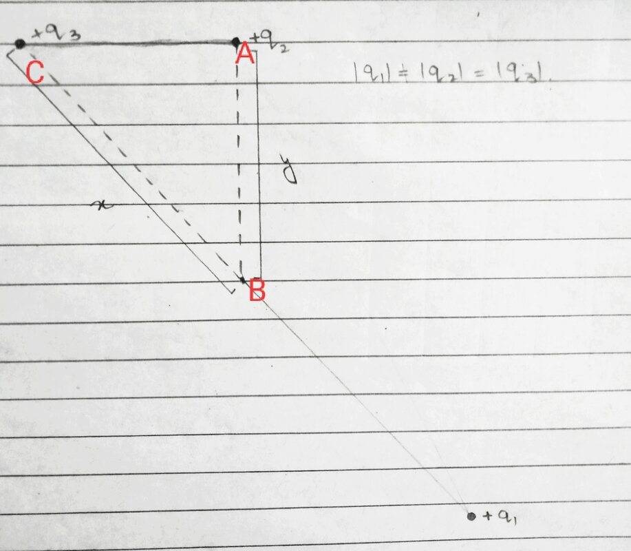

I tried to reframe my question and I hope I have now done it better. their are 3 particles +q₁,+q₂,+q₃ in the figure I have posted and we brought particle q₂ and q₃ from their initial position to their final position.
Now some work has been done on particle +q₃ and +q₂(that work is done against the force generated by particle q₁)
and these work add upon with their respective potential energies(I am talking about the potential energy of pair q₁,q₂ and q₁,q₃) and now their new potential energies are same.
Now I can't understand how there potential energy became same after reaching final position.

So we have two particles (##q_2## and ##q_3##) which start with different potential energies in the field of stationary charge ##q_1##.
The two particles are moved on different paths that take different amounts of work but wind up with the same potential energy as a result.
You express dismay at this result. What do you find startling about it?

Do the ##q_2## and ##q_3## have the same charge?
If so, then their potential energy "at infinity" is conventionally defined to be zero. The path-independence of the field means that their potential at the final point is fixed regardless of path.
Which means that their potential at the starting points is guaranteed to be just right so that the work done bringing them to the final point gets the right increment to potential energy.

Draw two paths. One from infinity to the final point with a stop at the starting position for ##q_2## and the other from infinithy to the final point with a stop at the starting position for ##q_3##.
If the field is conservative, the work done on both paths must be equal.
