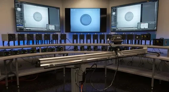

For example, FLIR: Infrared Camera Accuracy and Uncertainty in Plain Language
Infrared cameras are typically calibrated using multiple blackbody sources at different temperatures. The camera is mounted on a rotating platform and sequentially pointed at these reference sources.
Camera Accuracy Specs and the Uncertainty Equation​
You’ll notice that most IR camera data sheets show an accuracy specification such as ±2ºC or 2% of the reading. This specification is the result of a widely used uncertainty analysis technique called “Root‐Sum‐of‐Squares”, or RSS. The idea is to calculate the partial errors for each variable of the temperature measurement equation, square each error term, add them all together, and take the square root. While this equation sounds complex, it’s fairly straightforward. Determining the partial errors, on the other hand, can be tricky.
“Partial errors” can result from one of several variables in the typical IR camera temperature measurement equation, including:
  • Emissivity
  • Reflected ambient temperature
  • Transmittance
  • Atmosphere temperature
  • Camera response
  • Calibrator (blackbody) temperature accuracy
Once reasonable values are determined for the “partial errors” for each of the above terms, the overall error equation will look like this:
Where the ΔT1, ΔT2, ΔT3, etc are the partial errors of the variables in the measurement equation.
