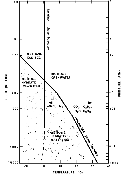

I really don't understand the formation of ice in the containment dome, the oil, gas and saltwater mixture coming out of the pipe should be warm enough to compensate for the cooling caused by the expansion of gas ??
Anyone have first hand experience or knowledge of what's at play ?
I thought I heard it was a condensate(?) from a chemical reaction
http://stevenjohnhibbs.wordpress.co...-fails-as-hydrate-ice-crystals-abort-mission/
The temp at that level is probably colder then freezing not likely warm at all.
Form what I understand it was not ice, but methane hydrate. Looks similar, but it is something completely different.
Makes sense. At that depth (~1500M), methane gas+water becomes methane hydrate ('an ice-like crystalline structure') below ~20C.
Phase diagram:
Phase diagram of methane with depth in meters and pressure in atm against temperature in degrees C, showing methane gas+ice, methane gas+water, methane hydrate+ice+water and methane hydrate+water+gas regions, with an ice-water boundary at 0 C and a hydrate-gas phase boundary sloping to the right.
