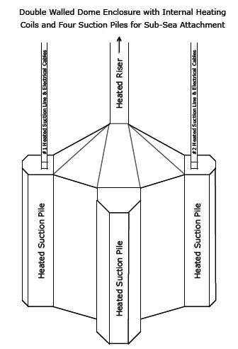

It seems to me that BP's first idea of putting a big funnel over the top of the leak was a good start, they just didn't expect so much methane hydrate slush to clog the funnel.
What they need to do is to build a simple heat exchanger inside the funnel and pump warm Gulf water through it to keep the slush from forming.
Anybody out there have any better ideas or improvements to this one?

You'd have to heat maybe a couple thousand feet of pipe/funnel, creating a water column over 20 degrees C isolated somehow from the surrounding water at 4C to avoid methane hydrates forming at that pressure. And I don't see a simple way of stopping the flow if necessary, even temporarily, without immediately creating an ice dam.

Have you even seen what the subsea architecture looks like? Where exactly would this device attach? The stack is currently sitting on top of the wellhead. A bent riser is sitting on top of the LMRP. If they remove any of those without killing the well it will be flowing wide open.
