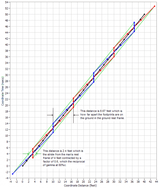

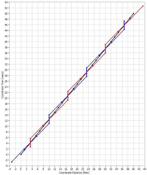

Since the man has taken 3 steps over the ground with his left foot, left foot has moved 12 feet over the ground.ghwellsjr said:Since the man has taken 6 steps covering 4 feet each, the ground has moved 24 feet behind him in 30 nanoseconds confirming a speed of 80%c.
No, that's not right. The man can walk at any speed short of c. Look at the second diagram. The man's body is traveling at 80%c. His left foot (blue) travels at 97.561%c but for about 13.5/16.5 % of the time so it comes out to 80%c.jartsa said:Since the man has taken 3 steps over the ground with his left foot, left foot has moved 12 feet over the ground.

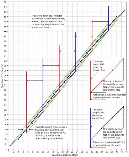

)True, as long as you're talking about the invariant Proper Time as depicted by the blue and red dots which is 3 nanoseconds on the ground and 3 nanoseconds in the air moving forward to the right as both my diagrams indicate.jartsa said:I disagree. When walking, invariant time schedule of a foot is: half of the time on the ground, half of the time in the air.
Yes, as long as all parts of your body are at rest with respect to each other. That's not the case with the walking man.jartsa said:An example of invariance of time schedules: I study physics 1 hour a day, astrology 3 hours a day, the ratio 1/3 is a frame independent invariant.

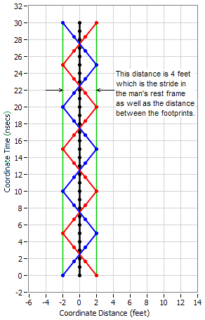

Half the time the left foot is pushing the ground behind the man and the other half the right foot is pushing the ground according to the man's rest frame. Look at the first diagram.jartsa said:When foot is in the air, it is moving over the ground. So we have: half of the time foot is moving over the ground, half of the time it is not moving over the ground. Those pauses cause a 50% decrease of average speed.
In the first diagram, the man is "taking a 24-foot walk" with six 4-foot steps, half with each foot.jartsa said:(I have always thought that when I walk 1 km, I take 1000 one meter steps. But actually I take 1000 two meter steps, 500 with each foot.)

Well let's see if we can get you unstuck.Jaams said:I'm mostly interested in talking about the scenario purely from the perspective of length contraction, which says that his footprints should end up being further apart.. right? Yet an onlooker would say that the man taking longer steps is length contracted? This is where I'm stuck.

I think I have to agree with you. I keep thinking of better ways to improve them. Here are my latest improvements. I have added notes on the diagrams to hopefully explain some of the confusing aspects.Simon Bridge said:In other words - the ground observer sees the man taking long leaps - allowing him to cover more ground despite his short stride.
