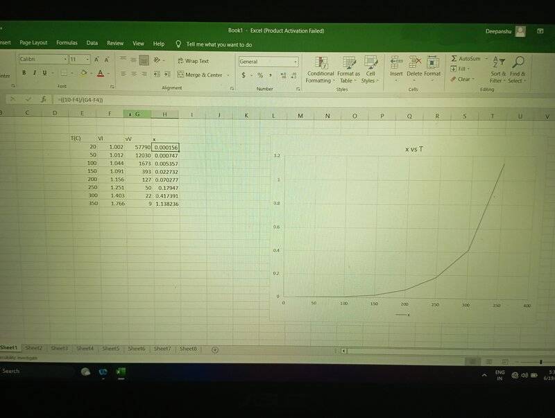

Below is an abbreviated steam table of specific volume (liters/kg) of saturated liquid water and saturated water vapor as a function of temperature (C). I would like you to do some calculations using the equation I developed in Post #2.
Assume we have a rigid container of volume 10 liters holding 1 kg of water (liquid + vapor). What is the value of ##\bar{v}=V/m## for this situation (liters/kg)? What is the mass fraction water vapor x in the container at each of the temperatures in the table? Make a graph of x vs T.

How can be fraction greater than 1 🙄?
It means that all the liquid water has evaporated, you no longer have vapor-liquid equilibrium, and the container is filled with superheated vapor (below the equilibrium vapor pressure).

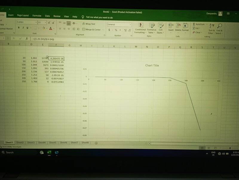

Not so fast. Now consider 1 kg of water in a 1.25 liter container.
container gonna be blast at negative value of x .
Am I right ?

No. We are assuming that the container is infinitely rigid.
It means that there is only liquid water remaining in the container under very high pressure; the pressure is above the equilibrium vapor pressure of water at the temperature, and the specific volume is less than the equilibrium specific volume of liquid water at the temperature.
