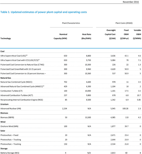

This whole thread has pointed out the higher cost of solar to traditional. http://energyrates.ca/ontario/green-energy-ontario/
Another point is personally owning the electricity / installation. A very attractive feature that makes economic sense...sometimes (smelting, pulp) making your own coal / hydro plant makes economic sense. "Soon" it will "make sense" even for jane doe consumer.
Who on Earth thinks that paying to get electricity from here to there, a profit margin, supporting billions in infrastructure, at the mercy of market pricing is better economically than simply owning your own power generation equipment and having it on your own property?
