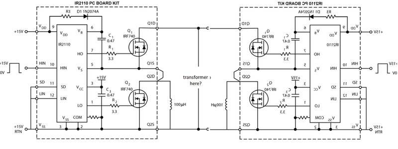

Do not trust a simple schematic unless you know the credentials of who did it. When there are specs like max 60V ask why and get component specs and examine the interface. Trustworthy designs come from TI, Analog Deices, Microchip, Hitachi, Toshiba, etc. This is just a rookie undergraduate example. Using DO NOT EXCEED (DNE) levels is not a good design practice. Use the values in the tables where it is guaranteed. U1 is DNE 22V This also would exceed Vgs(max).
If this is your 1st attempt , it is impossible to design anything and have it work without failure and it will cost much more than buying one. But you may learn tools in the process. I recommend fast learners buy one then analyze it for load impedance ratio error and noise. Then learn how that works. It's simple resistor divider Ohms Law. The voltage drop load regulation error is the same % ratio of impedances for small values. Obviously 50% drop they are equal 1:1

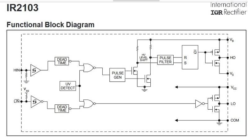

Ok I think I understand that, so which should I choose ir2103 or lt1160 in your opinion? are there any books that you recommend for learning?

so these are the N chan fets that i have settled on
IRFP4668
I am still unclear how to make "The two halves a whole" or how to wire it up. As far as I can work out, the N chan fets are used as high side switches. The drain is connected to the supply voltage in my case it will be 55v and source to load. The gate needs the correct vgs to turn it on then I was looking at direct drive, level shifted drive, or bootstrap gate drive. In the picture you provided its a bootstrap driver and I suppose the logic in pins are important can I please have some guidance. Thanks again!
