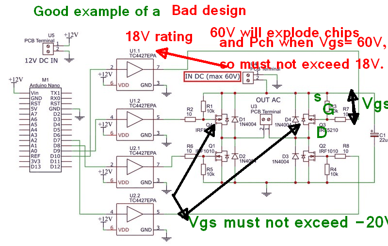

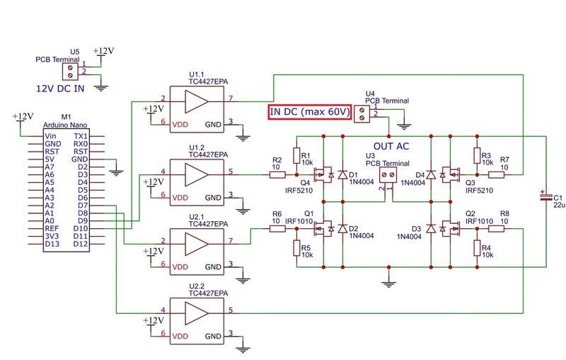

Your high side transistors will likely be damaged as they will have 38V (50V - 12V) to 50V across the gate and source. The absolute maximum is 20V. Even if they survive they will never turn off as they need less than 2V to do that.
You need to find some high side gate drivers for them. Many high side gate drivers are designed to drive N-Channel FETs. Make sure to either swap out the P-Chanel ones or get a driver that can drive them.
BoB

will this not do, it specifys (in dc (max 60v)) also is there any way i can upload a video of the machine in motion
No, it will not do above about 15 volts input.
I would suggest you use a pair of half-bridge drivers, with four N-channel MOSFETs. N-chan are cheaper than P-chan, have lower on-resistance, and switch faster.

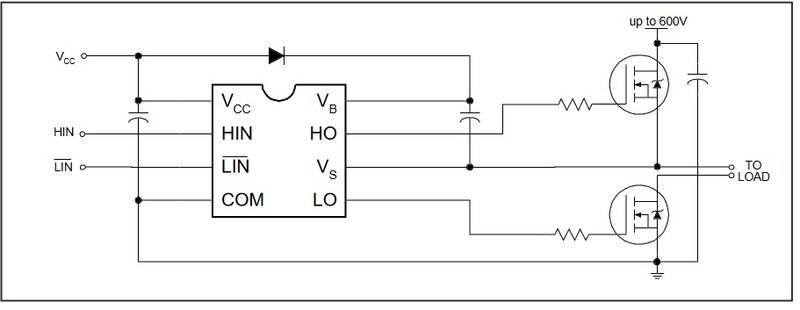

Google to find a datasheet for this; IR2103 Half-Bridge Driver.

ok very interesting so i just need one IR2103 Half-Bridge Driver. and use which pins to drive the drive the other two n-channel mosfets

No. You need two halves to make a whole bridge.
Study the datasheet to see how the boost voltage is generated, that controls the gate of the high-side switch.

The IR2103P1 can handle 600 volts, so it should also work with 60 volts.

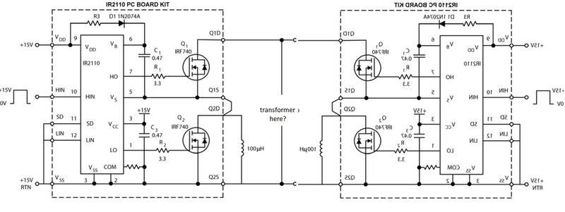

You will need to take a couple of days to read and consider the datasheet and the application note. You must learn to think about and question your understanding of the device through the literature.
I don't know the answers to member's questions, but I know I can find the answers by searching and thinking. There is no shortcut to learning how to question yourself, you must learn to do it. Ask yourself the questions you are asking me. Ask yourself how I might find the answer, then do that yourself.
Program the microcontroller to change 4 pins. Each pin will control one MOSFET through a HB. Notice that some inputs to the HB driver pins are inverted. You will need a timer to set the 50 Hz frequency.
Once that is sorted, you can convert the driver control to produce more of a sinewave, but first produce the 50 Hz square wave.
