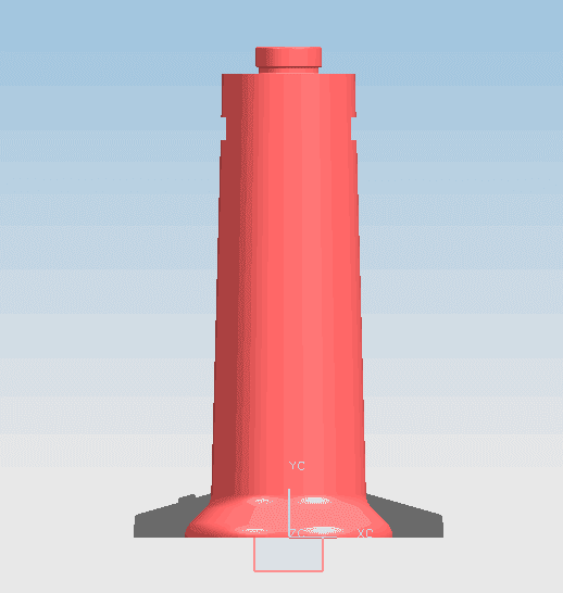

Hello Everyone!
I was asked to calculate what is the wind speed that can flip a traffic barrel, which picture I'm attaching. It's composed of a barrel (red) and base (grey), which is filled with 14 liters of water.
The picture only resembles the shape. The dimensions are these
Barrel:
Height: 105 cm ( without counting the small container for light on top)
Top diameter: 30 cm
Diameter at base level: 35 cm
Bottom diameter: 42 cm
weight: around 3.5 kg
Base:
Inner diameter at top: 35 cm
Inner diameter at bottom: 42 cm
Outer diameter: 60 cm
weight: 3.5 kg empty, 17.5 kg filled.with waterI've cracked my head for days and can't find the answer ... This is my last chance!
Thanks,
Fabian

Why do you need the MOI? If the drum tips slowly, it wouldn't seem to be needed. Just calculate the torque required to tip the drum up to and past equilibrium...:smile:
Agreed
Weight times horizontal distance between lower edge and horizontal position of centre of mass is the required torque to tip the drum.
Fd = cd 1/2 ρ v2 A
gives the force on a body with air flowing past it.
Area A
Velocity v
density ρ
cd is coefficient of drag, which is different for different shapes. This link has a list of cd values for a list of objects but not a cylinder in crossflow. Semi cylinder or even person standing would have a cd of say 1.2. Work out the area presented by your drum and you have all the required figures for wind force. I would think that you could take the torque as this force times half the height of the drum.
Re-arrange the numbers to bring v2 on one side and then square root it. I wonder what answer you will get.

Shouldn't the torque be the weight times vertical distance between top edge and centre of mass? The wind acts horizontally ...
I understand what you are saying ... Its Torque, not force. I did a free object diagram and the torque is T = m*g*r (r = radius).
Say I get the drag coefficient. What about air density ?
never mind. Changes with temperature, and other factors. I think I have what I need. Thanks!
If you want ballpark figures, 1 kg / m cube will do.
You got the bit about torque, I think. You have to lift the CM up, about the bottom edge so it's the horizontal distance that's needed.
around 53 km/h ...
I could believe that. That speed is not a mild breeze and it's not a hurricane (credibility test). There will be a velocity gradient near the ground so the 'weather forecast' / recorded wind speed will probably be a bit higher than your value.
You should be pretty pleased with yourself, I reckon.[emoji846]
Edit: 53kph is Beaufort scale Force 7 - high wind, moderate gale. I wouldn't be surprised to see stuff scooting along the road in that sort of a wind.
