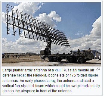

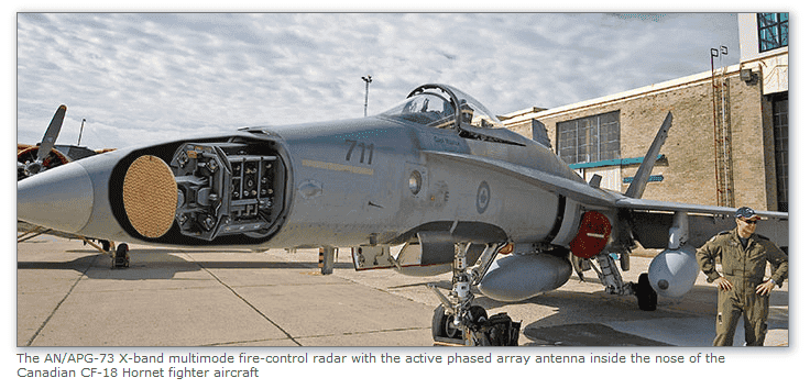

Don't radars use a bunch of low power solid state RF sources to create an RF beam of higher power? I was thinking the same for a router-based microwave :cool:
  • #54
No doubt but the process of adding more and more sources becomes diminishing returns for each layer of combiners - as I mentioned above. Initially, pairs are combined and then each pair of pairs is combined and then pairs of pairs of pairs. etc. You need 2,4,8,16 amps for it to work.
I suspect the limit will still bent more than 16X. Router sources would require many more layers AND they would need to be frequency locked (not possible) for nominally lossless combiners to work at all. Your multi - amplifier Radar sources are all driven from the same source so the phases are right for combining according to the above description.
The devil is always in the Engineering detail.
There will be waveguide equivalents but I don't know if a single multi-port combiner is in fact feasible. One problem is that 2GHz waveguide is massive and it would fill up your kitchen!

The problem with your proposal is much worse. Do you know how antenna array beam forming and beam steering works? You use destructive interference at the beam angles where you want little/no power, and constructive interference where you want the most power. But there is no magic going on here -- you still are transmitting full power out of all of the antennas in the array, and losing all of the power at the angles where you are using destructive interference to cancel the Tx waveform.
You do get some addition of the power in the main lobe(s), but you still are wasting all of the power at the angles where you are generating destructive interference. It's not like the power at those angles somehow magically gets transferred to the angles where you have constructive interference.
Antenna arrays are not about generating more power. They are about sacrificing power in order to generate a Tx power pattern that is more focused.
https://en.wikipedia.org/wiki/Antenna_array
NO, they use a high power device like a magnetron etc as a microwave oven does
  • #60
Even for phased arrays? I thought there were lower power RF sources for each antenna in the array? Like the giant phased arrays you see on battleships.
