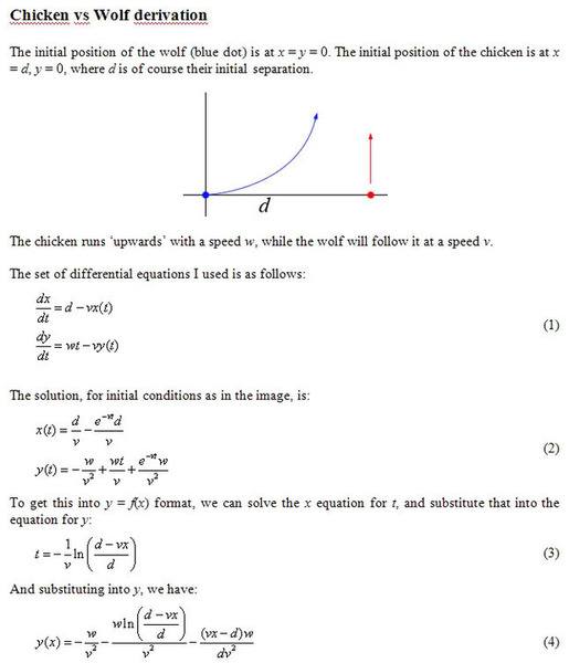

Hi,
First of all, I hope this is the right forum for this. I was thinking about the brain teaser forum too, but thought this was more appropriate (at least, I think there's no trick involved).Someone on another forum asked the following question.
Suppose you have a wolf and a chicken on a cartesian x-y plane. The chicken starts running away from the wolf, but it moves only in the +y direction, with constant speed [itex]w[/itex]
The wolf, initially on the same axis as the chicken, separated by a distance [itex]d[/itex], will start to move toward the chicken, at constant speed [itex]v[/itex].
The crux is that the wolf always faces the chicken at all times. It does not 'think ahead' and try to intercept the chicken, he just empties his mind, stares at the chicken and starts running.Now, there's a few questions like 'how long does it take the wolf to capture the chicken', or at what distance did the wolf run, etc. But my question is, what is the path of the wolf??The setting again, as worded by the original poster:
(1) There is a wolf and a chicken initially separated by some distance.
(2) The wolf runs at a speed that is faster than the chicken's.
(3) The chicken and wolf begin running at the same time. The chicken runs perpendicular to the line that would initially connect them and can only run in that direction. The wolf on the other hand runs such that he is always facing the chicken.
We've been trying to solve this with a few people, and I think I have finally come close, except for one major detail.I wrote a quick and dirty simulation which shows the following behavior (blue = wolf, red = chicken):
First, the speed of the chicken is 0.5, and the wolf 0.7:
Relatively slow wolf
Then I increase the speed of the wolf to 1.5 and the interception is of course a bit sooner:
Relatively fast wolf
Here's two video's of these simulations:
I then derived an equation for the path, and graphed it, and got:
The derivation is as such:
This is based on the fact that the wolf faces the direction (d - vx, wt - vy) , which is the vector between the wolf and the chicken (since wt is the y-coordinate of the chicken). So the x coordinate of the wolf should increase in the (d-vx) direction, and the y coordinate in the (wt - vy) direction.
The graph above is for d = 10, v = 0.7 and w = 0.7 (as in the simulation).
The graph looks similar, but there's one major problem: the vertical asymptote is not at x = d!
I didn't think this was a problem at first, the wolf had merely captured the chicken already at x = d, and the graph is nonsensical after that.
However, I discovered that the position of the asymptote depends on the speeds v and w... For example, if the speeds are exactly the same, I would expect the asymptote to be at x = d (as always), and the wolf just trailing behind the chicken at a constant distance, never quite reaching x = d.
This is true in my graph if v = w = 1. It is NOT true if v = w = 1/2 or 2 or ... If v = w = 1/2, the asymptote is twice as far, at x = 20 instead of 10. If v = w = 2, it's at x = 5...
This is what I don't understand... I don't think my equation is correct therefor.
What do you think?
Also, I don't know any way to verify that the speed of the wolf is constant. It probably isn't at all, while it should be...
Anyway got any thought on this?
Ok, scratch most of the above :P
I've noticed my set of DE's wasn't correct. I think it should be this:
[itex]\mathbf{p}_w[/itex] is the position vector of the wolf. [itex]\mathbf{p}_c[/itex] is the position vector of the chicken. Their difference is the vector between wolf and chicken, which is the direction the wolf runs in.
With this, the equation becomes:
[tex]y(x) = -wv - w \ln \left( \frac{d-x}{d} \right)v - \frac{x-d}{d} wv[/tex]
And the graph looks similar, but now has a vertical asymptote for every v and w. I think I finally got it, did I?!
On second thought... When I try to determine when the chicken is intercepted, there is no solution.
Solving x(t) = d gives [itex]\exp(-t/v) = 0[/itex], no solution (well, t to infinity).
Solving y(t) = wt gives t = 0, which is valid of course, but it's not the solution we need...
Damn!

Hmm, possibly, the mathworld result reduces to the one I had in mind, but I'll post mine anyhow.

I tried reproducing the equations from mathworld, but now using arbitrary v and w instead of 1, but somehow they cancel out completely...
Also, I think there might be a mistake on their site, although I can't imagine that. From equation (11) to (13). In (11) they have:
[tex]xy' + t - y = 0[/tex]
Then they note that, using the arc length integral:
[tex]s = \int \sqrt{1 + (y')^2}\, dx = vt = t[/tex]
(since v = 1)
Then they substitute t = that integral into (11) and magically transform the +t into -t! :
[tex]xy' - y - \int \sqrt{1 + (y')^2}\, dx[/tex]
There was +t in (11), and it became minus the integral in (13)...?I will have a look at your solution later. I'm not sure how the mathworld result reduces to this yet... It doesn't seem very similar :p
Ok, I've worked your example through and solved it, but a few questions. If [itex]\alpha = d^{w/v}[/itex] then [itex]\alpha d^{1-w/v} = d^{w/v}d^{1-w/v} = d[/itex], right? So your final solution can be simplified quite a bit.Anyway, I wrote it all out and the determined the y-intercept of the function, which would be the point of interception. I got a surprisingly simple result:
[tex]Y(0)= \frac{vwd}{v^2-w^2}[/tex]
And the time it takes the wolf to get there is of course the same as the time it takes the chicken to get there, which is
[tex]t = \frac{Y(0)}{w} = \frac{vd}{v^2-w^2}[/tex]The original poster on the other forum has confirmed that this is correct. He is claiming though that there is a MUCH simpler solution which tells us the time and interception point without much algebra at all. Of course, we don't get the path of the wolf then, but the question was to determine the time and interception point. I'm waiting for him to show me the easy solution.
