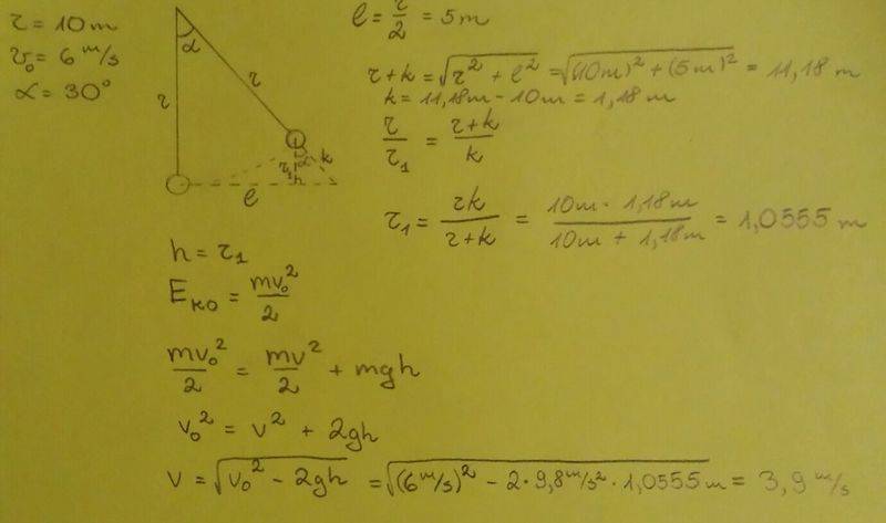

A wrecking ball swings at the end of a 10.0-m cable on a
vertical circular arc. The crane operator manages to give the ball a
speed of 6.00 m/s as the ball passes through the lowest point of its
swing and then gives the ball no further assistance. Friction and
air resistance are negligible. What speed v does the ball have
when the cable makes an angle of 30.0° with respect to the
vertical?

The answer must be 3.1 m/s
When calculating r + k, note that the base of the triangle is not 5 m.
You might try a different construction. Draw a horizontal auxiliary line from the final position of the ball over to the vertical string at the initial position.
Sorry, I saw my mistake xD .
If I draw a line from initial to final position, I get an isosceles triangle. Still I don't know how to find the height.
Here's the horizontal line I was suggesting.

Solved it, thanks!
