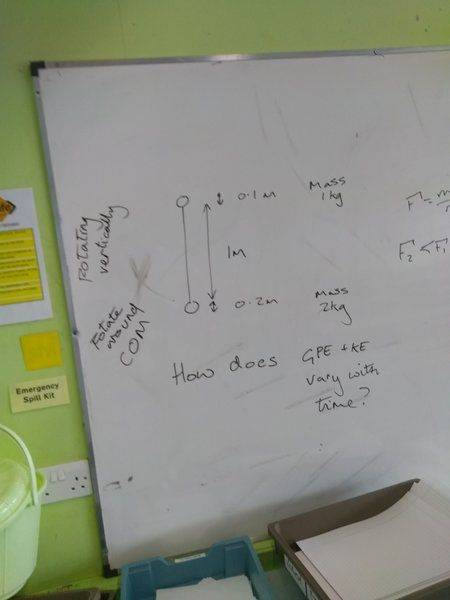

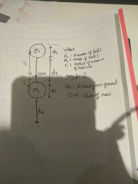

Yes I was watching it to help understand how kinectic energy changes with rotation, the overall question I'm trying to answer is actually more complex than stated above: If two balls of mass m1 and m2 and diameter d1 and d2 are attached by a string and the system rotates vertically how does gpe and ke change over time, I have worked out how height changes with respect to time of the projectile, found how the CoM is defined using the diameters and masses of the balls the next step I think is to find how the gpe and ke changes in one of the rotations then apply that to the second mass and merge all my equations together somehow but I think my problem lies in the understanding in the energy in a rotating system.

I am having trouble visualizing the problem you are describing. Can you please provide a diagram.
The whiteboard is the original question the paper is my generalisation
Rainbowbarf756 said:
The whiteboard is the original question the paper is my generalisationView attachment 211839 View attachment 211840
The whiteboard question is unclear. Is there anything holding the whole system up, against gravity, or is the pair of rotating balls in free fall?
Imagine it rotates forward I guess but ultimately I will model it as a projectile with initial velocity u and at an angle theta
For the time being I was thinking of it where it has gpe but is not affected by gravity does that make sense? So it doesn't fall.

Ok, so you can separate the motion of the mass centre of the system, a simple parabolic trajectory, from the motion of the two balls relative to that.

A mere matter of addition. Having found the GPE of the mass centre as a function of time, and the relative GPEs of the balls as a function of time, add them together,
You can do the same with the velocities, adding them vectorially.

The GPE of the system will be the GPE of the common mass centre. To find the GPE of the individual balls, apportion that in proportion to the masses, then adjust by their heights relative to the common mass centre.
To find the KE of a ball, the safest way is to find its velocity in the ground frame. To find that, find the velocity of the common mass centre then add (vectorially) its velocity relative to that.
