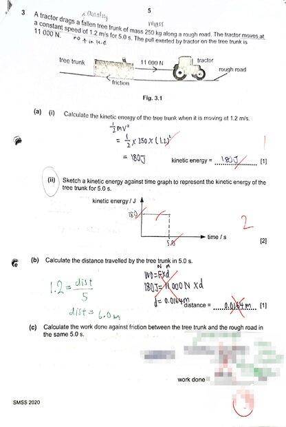

how to calculate work done against friction? I saw alot of people suggesting to use the formula involving cosine if I'm not wrong but it's not in my syallbus, so is there another way to calculate it?
WD = F x D
Do you consider inclined plane ?
ellieee said:
Homework Statement:: how to calculate work done against friction? I saw a lot of people suggesting to use the formula involving cosine if I'm not wrong but it's not in my syallbus, so is there another way to calculate it?
Relevant Equations:: WD = F x D
You need to state the whole question or we're just guessing.
qn 3c
refer to qn 3c pls:) not inclined plane
As you referred WD=F*D
F=11,000 N
D is a distance meter the tractor goes in 5 seconds.
F=11,000 N
oh but the answer is (11 000)(6.0) = 66 000 J though
So, what is D?
onatirec said:
So, what is D?
oh I was careless and didn't see properly , sorry
