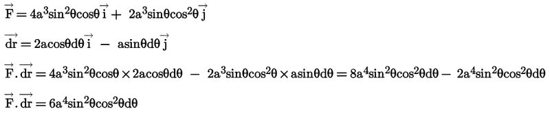

If you are going from A to C, the limits of integration are from ##\theta=0## to ##\theta = \frac{\pi}{2}##. From the equations for F and dr that I gave in post #16, what is the equation for F dotted with dr?
Is it true ?!

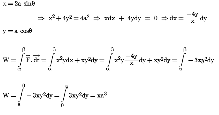

Forget ##\theta## as a variable. Try this. You have $$x=2a\sin\theta~;~~2y=2a\cos\theta.$$It follows that $$x^2+4y^2=4a^2 \implies xdx+4ydy=0 \implies dx=-\frac{4y}{x}dy$$ Now $$\mathbf{F}\cdot d\mathbf{r}=(x^2y~\mathbf{\hat x}+xy^2~\mathbf{\hat y})\cdot(dx~\mathbf{\hat x}+dy~\mathbf{\hat y})
=x^2ydx+xy^2dy.$$ Substitute the expression for ##dx## and integrate over ##y##.
Can I send a picture of my work ?! The final answer is unusual ...

I don't get the factor as 6. Did you handle the signs correctly? The rest looks fine.

  • #37
What about Theta ?! Did I specify theta correctly?
I get the factor 6 again ! Let me send a picture ...
  • #38
  • #39
I'm getting what you are getting.
$$ \int 3 x y^2 dy = \int 3 \cdot y^2 \cdot 2 \sqrt{a^2 - y^2} dy $$
Let:
##\frac{y}{a} = \sin \beta##
## \frac{ \sqrt{a^2 - y^2} }{a} = \cos \beta##
It follows that
$$ y^2 = a^2 \sin^2 \beta$$
$$\sqrt{a^2 - y^2} = a \cos \beta$$
$$ dy = a \cos \beta d \beta$$
$$ \implies \int 3 x y^2 dy = 6 a^4 \int \sin^2 \beta \cos^2 \beta d \beta $$

It is a line integral, not a double integral, so you must arrange that there is only one variable in the integrand. If you want to do it as an integral wrt y then you must first replace all the occurrences of x with what x is as a function of y.
But really, the parametric approach using theta is much easier.
Likes MatinSAR and erobz

Hi @MatinSAR. Can I point out a fundamental mistake you are making? I don’t think anyone has mentioned it yet (apologies if they already have).
The final expression for W can not contain x or y (or θ). These are variables which change as you move along the path. They must disappear when the definite integral is evaluated.
You made the same mistake in your Post #1 solution, where your final expression for W contained x and y.
The expression for W can contains only given constants (here only the 'a') and pure numbers like 5, π and √2 (just picking random values as examples).
For example, if you determine the formula for the circumference of a circle, x²+y²=a², it wouldn’t make sense to have x and/or y in the final formula.
