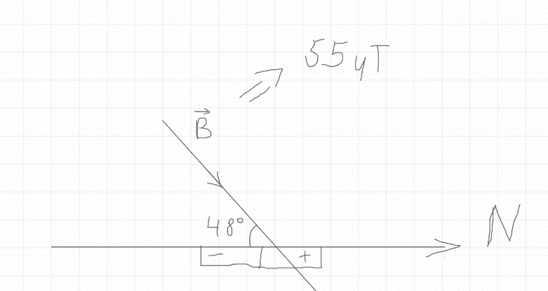

Compass needle magnetic dipole moment is 4mA*m^2 , in the location of the compass Earth's magnetic field is 55 microteslas , and pointing north and downwards at 48 degree angle with compass needle. What amount of work is needed to turn compass needle from pointing North to South?
Hand-drawn sketch of a compass needle on a horizontal line with N marked at right, labelled - and + ends, at 48 degrees to a magnetic field B arrow pointing down-left, with a 55 microtesla arrow at top right.
So this is a sketch I made of the situation

my approach is incorrect , and Idon't seem to find the mistake , maybe B*p isn't correct. Any ideas?
On this one, you need to work in the x-y plane: The ## B ## that generates the torque in the direction of interest lies in the x-y plane. (Calling north as the positive x-axis and and west as the positive y-axis, the ## B ## of interest is ## B_x ##). The torque is proportional to ## \sin{\theta} ##, and the work is ##\int \tau_o \sin{\theta} \, d \theta ##, where ## \tau_o ## is the value for ## \theta=90 ## degrees. (Note: The axis of rotation is the z-axis. The ## B_z ## that you computed will not cause any torque in the z-direction=that is why your calculation doesn't work).
Edit: Note: The problem can also be worked as a rotation about the y-axis, but you will find that the ## B_z ## has a null effect, with the y component of the torque being in opposite directions as the dipole moment passes through the z-axis. Once again it is ##B_x ## that determines how much work is needed.

Sorry , but I didn't managed to understand. Can you maybe explain a bit simpler?
The problem is telling you that the Earth's magnetic field vector at the location of the needle has a magnetic dip angle of 48° below the xy-plane. The needle is constrained to move in the xy-plane. Initially, it is aligned with the horizontal component of the magnetic field, Bh which is less than the magnitude of 55 μT. (What is the value of Bh?) You are asked to find how much work you need to do on the needle in order to rotate it by 180° in the xy-plane. It's easier to use energy considerations instead of torques. What is the potential energy of a magnetic moment in a magnetic field?

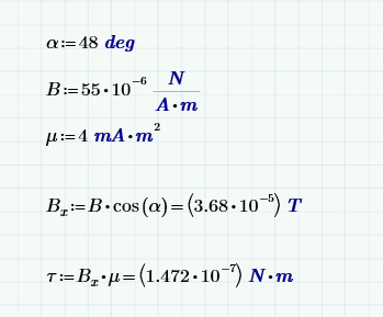

Mathcad worksheet with alpha := 48 deg, B := 55·10^-6 N/(A·m), mu := 4 mA·m^2, Bx := B·cos(alpha) = 3.68·10^-5 T, and tau := Bx·mu = 1.472·10^-7 N·m.
Yes , I have calculated x projection of Magnetic field, and calculated the torque , but I don't know what method to use to calculate the work.

I pointed that out in post #4.
Ugnius said:
isn't E = τ*θ , θ being the dip angle?
Nope. Read about magnetic potential energy here.

I see , and should I use the full magnetic field , or just the x projection ?
Do it both ways and see if it matters. Be careful with the "before" and "after" angles in each case.
