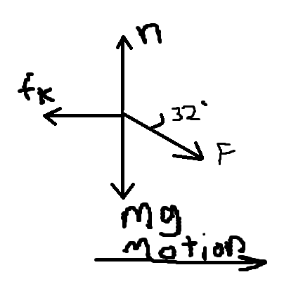

Is this picture drawn correctly?
How do I solve for F? When I write out the x and y components for the forces I get this:
Focs32 + ukn = 0
Fsin32 + n - mg = 0
I can't solve for F because I have 2 unknowns in each equation. What am I doing wrong? Or perhaps this is completely the wrong approach in finding the force that I need to find for part a to be able to find the Work.
Yes.
Focs32 + ukn = 0
Good.
Fsin32 + n - mg = 0
The y component of F should be negative.
You have two equations and two unknowns. Just right! (Solve them together, using substitution or any other method.)

You never corrected the error that I pointed out in my last post. You have the wrong sign for the y-component of the applied force. You'll need to rewrite your equation.

I corrected it my changing the degrees to 328. That way sin is negative.
Edit: I think I see my error and its my calculation of ukmg its supposed to be 53.312 not .53312
When I fixed that my Force is 51.8515 N and Normal force is 129.3312 N. Either way the weight force is still greater then the normal force, but that should be shouldn't it? Since it's keeping it on the ground.

Please redo your calculations. Your value for F is incorrect. And the fact that your normal force is less than the weight indicates a problem.
Just start with your two equations and redo your work carefully.

W = Fd is not correct; don't forget the angle between F and d.

Ok W = Fdcos(theta) Should I use a theta value of 360 - given angle. Don't think it matters either way but I guess I'll do 360 - given angle. Ok so that finds Work. Is part b increase in thermal energy = fkd = uk*n*d ?

The angle between the force and the displacement is given as 32 degrees.
Yes.

K thanks for the help, entered my answers in and both are correct.
