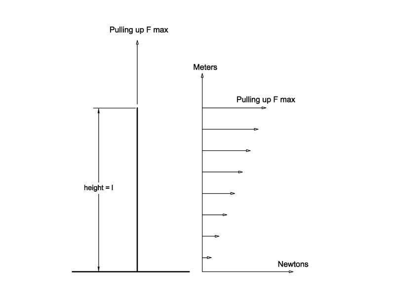

The net change in energy is the net amount of work done by the pulling force between the full coiled position and the full extension of the rope, until it just takes off from the ground (without considering internal forces in the rope explained by @haruspex above).Differentiate it said:Homework Statement:: (view the image)
Relevant Equations:: W = ∆KE
The solution said that Average power= net change in energy/time, but why is that true? If you have a different way of solving it, it would be helpful too
Both components of work, force and height, are constantly increasing from a zero value up to the maximum force of the weight of the rope off the ground, which should be ##F_{max}=mg=\lambda lg##

Now on to the chain:
I feel like we should be able to argue that the mass moving at velocity ##v## is actually a function of ##x## i.e. ##m(x) = \lambda x## and incorporate it into the integral on the LHS and perhaps resolve the issue of no work being done by the force ##F##...
$$ \int_{0}^{l} \frac{F(x)}{\lambda x} dx = \int_{v}^{v} v ~dv = 0 $$
We still get no work?
Lets ignore the fact that the mass being pulled at velocity ##v## is a function of ##x## ( as far as integration is concerned) and leave it on the RHS.
$$ \int_{0}^{l} F(x)~dx = \lambda x \int_{v}^{v} v ~dv = 0 $$
Still no work?
I feel like this is a problem because in order to solve the OP via energy methods, we are basically assuming (for this simplified problem and for the OP) seemingly against all interpretations that:
$$ W = \int_{0}^{l} F ~ dx = \frac{1}{2} \lambda l v^2 \neq 0 $$
