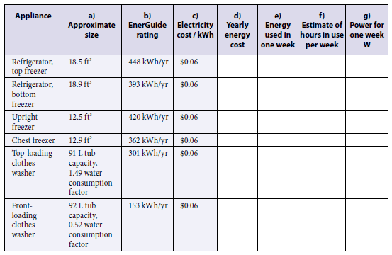

Fill in the empty columns of the following table:
y = ΔE x c
P = ΔE/Δt
ΔE = Y/ Δt
[/B]
Part d) Yearly energy cost:
Use Y=ΔE x c
Refrigerator, top freezer:
Y = (448 kWh/yr) ($ 0.06)
Y = $ 26. 88/yr
Refrigerator, bottom freezer:
Y = (393 kWh/yr) ($ 0.06)
Y = $ 23.58/yr
Upright freezer:
Y = (420 kWh/yr) ($ 0.06)
Y= $ 25.20/yr
Chest freezer:
Y = (362 kWh/yr) ($ 0.06)
Y = $21.72/yr
Top-loading clothes washer:
Y = (301 kWh/yr) ($ 0.06)
Y = $ 18.06 / yr
Front-loading clothes washer:
Y =(153 kWh/yr) ($ 0.06)
Y = $ 9.18/yr
Part e) Energy used in one week:
Use ΔE = Y/Δt
ΔE = 448 kWh /yr / 52 weeks
= 8.62 kWh/week
ΔE = 393 kWh/yr / 52 weeks
= 7.56 kWh/week
Upright freezer:
ΔE = 420 kWh/yr / 52 weeks
= 8.08 kWh/week
Chest freezer:
ΔE = 362 kWh/yr / 52 weeks
= 6.96 kWh/ week
Top- loading clothes washer:
ΔE = 301 kWh/yr / 52 weeks
= 5.79 kWh/ week
ΔE = 153 kWh/yr / 52 weeks
= 2.9 kWh/week
Part f) Estimate of hours in use per week:
Okay, so for all the refrigerators and freezers, I estimated the hours of use to be 168 hours, since I assumed these appliances are being used all day for the entire week. ( I am not sure if that is correct)
For the washers, I estimated the hours per week to be 5 hours.
Can someone please tell me if my estimate is correct, or do I need to put a different amount of hours for each appliance?
Here is part g) using my estimate of hours per week from part f)
Use P = ΔE/ Δt
P = 8.62 kWh/ week / 168 hrs/week
= 0.05 kW or 50 W
P = 7.56 kWh /week /168 hrs/week
= 0.045 kW or 45 W
Upright freezer:
P = 8.08 kWh/week / 168 hrs/week
= 0.048 kW or 48 W
Chest freezer:
P = 6.69 kWh/week / 168 hrs/week
= 0.041 kW or 41 W
Top-loading clothes washer :
P = 5.79 kWh /week / 5 hrs/week
= 1.158 kW or 1158 W
P = 2.9 kWh /week / 5 hrs/ week
= 0.58 kW or 580 W
Is my process and answer correct?
Any help would be appreciated :biggrin:

Should be fine if you have to guess values.
The approach is fine everywhere, didn't check all the numbers, computers can do that better.
Real freezers tend to switch between cooling and staying passive frequently, but the duty cycle will depend on the specific product.
If I changed the hours of use per week to between 80 and 100 hours, would that make sense?
Like this:
Top freezer: 95 hrs
bottom freezer: 85 hrs
upright freezer: 90hrs
chest freezer: 80 hrs
I am estimating the hours, so I can choose any values right?
Sorry for the late reply.
mfb said:
I'm not sure if that is a better answer.
Okay, so should I just use my original estimated hours?
mfb said:
I would use those.
Okay, but does it make sense that the power for the freezers are so low while the power for the washers are high?
mfb said:
Why do you think this would be an issue?
Well, I just thought that since the freezers are being used more hours per week the power would be higher.. but I guess that is not what they are asking of me in this question.
Anyway, thanks for the help! :biggrin:
