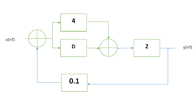

Write function for control system block
ongxom
25
Block diagram of a discrete-time feedback system: input x[nT] enters a summing junction, splits into a branch with gain 4 and a branch with delay D, which sum into a block with gain 2 giving output y[nT], with a feedback path of gain 0.1 back to the input summing junction.

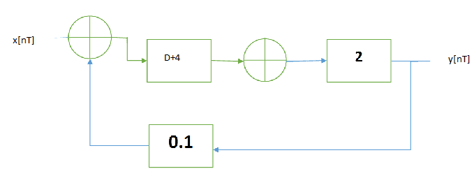

4 and D are parallel so we add them :
Block diagram of a discrete-time feedback system: input x[nT] enters a summing junction, then block D+4, then a second summing junction, then block 2, giving output y[nT]; output feeds back through block 0.1 to the first summing junction.

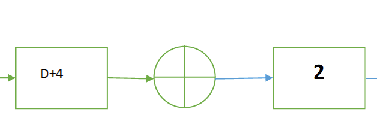

I am stucking in the simplication of this block
Block diagram: an input arrow enters a block labeled D+4, feeds a summing junction drawn as a circle with a cross, then a blue arrow leads into a block labeled 2.
Should I group these elements to a function called w[nT], so
y[nT]/x[nT]=1/(1-0.1w[nT])
and by my reduction w[nT]=2(4+D), is it correct ?
In going from the diagram in (1) to that in (3) you replaced the 3 symbols by 1, so that summing symbol should have disappeared, too. Then simplify a block D+4 followed by a 2 into one of 2(D+4).
