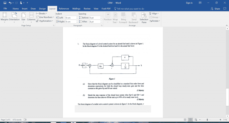

How to show a block diagram can be simplified to a standard first order form for the diagram shown in the image attached and the question is shown in 1.a
Standard first order form K/(1+tD) where K gain and t is time constant
[/B]
So i got ((Kb*H-h)*Kp-4)*1/2s = h Is this correct? and how do i show it in standard first order form from here? Thanks

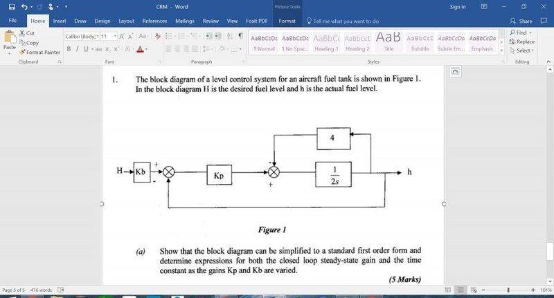

Figure 1 shows two closed loops: An inner and an outer loop.
Use Mason's rule to calculate the transfer function as for the inner loop.
Insert this inner transfer function in the outer loop and use Mason again to calculate h(s)/H(s) for the outer loop ( the transfer function for the outer loop ).
The characteristic equation for h(s)/H(s) will be in the form:
as + b = 0 → τ = b / a.
Enlarged image of diagram as requested
Hesch sorry I am not quite sure how from what youve said i can show it is a first order system as i need to show it in the form h = K/(1+tD), I am just not sure how to get there from what i worked out
You don't need to show in this form.
Using Mason you should get:
h(s)/H(s) = Kp * Kb / ( 2s + 4 + Kp ) →
h(s) = H(s) * Kp * Kb / ( 2s + 4 + Kp )
( if you wish )
I think it's nearly there; Check what's fed back via the "4" block. That 4 looks mighty lonely in your equation, given that the term its being summed with is bound to have some units associated with it... :smile: .
To determine the steady state gain from the above equation, let s → 0, so
h(0) = H(0) * Kp * Kb / ( 4 + Kp )
Ah yeah i understand what you have done now actually Hesch, thanks for the help guys.
