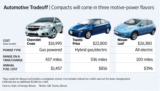

I have revisited the battery and energy cost per mile claims for the EV / battery exchange proposal from the company http://www.betterplace.com" . The CEO stated a life cycle cost of 4-6 cents per mile for the battery. Now I believe that appears plausible, even likely. My calculations/assumptions:
[tex] \begin{array}{l|rrrr}<br /> \mbox{} & \mbox{EV sedan}\\<br /> \mbox{} & \mbox{5-seat}\\<br /> \hline<br /> \mbox{Vehicle Parameters}\\<br /> \mbox{range(miles)}&100\\<br /> \mbox{efficiency battery-to-wheel (kWh/mile)}&0.22\\<br /> \hline<br /> \mbox{Battery parameters: }\\<br /> \mbox{lifetime charge cycles}&3000\\<br /> \mbox{lifetime range of pack}\\<br /> \mbox{ 70 percent capacity (miles)}&210000\\<br /> \mbox{pack capacity (kWh)}&22\\<br /> \hline<br /> \mbox{Costs:}\\<br /> \mbox{battery per kWh (dollars)}&400\\<br /> \mbox{battery per pack (dollars 1000)}&8.8\\<br /> \mbox{battery pack + spares (dollars 1000)}&11.5\\<br /> \hline<br /> \mbox{Summary:}\\<br /> \mbox{battery lifetime cost (cents/mi)}&5.5\\<br /> \mbox{energy cost @9cents/kWh}&2.3\\<br /> \mbox{total battery + energy cost (cents/mi)}&7.8\\<br /> \hline<br /> \mbox{ICE vehicle fuel cost}\\<br /> \mbox{@25MPG, @2.6 dollars /gal (dollars) }&10.5\\<br /> \end{array}[/tex]
Or 20% better than a comparable internal combustion vehicle. That's just battery & fuel costs. We may also expect savings on the EV only drive train/chassis versus the internal combustion comparable, that is a $2.5k electric motor displaces in the ICE:
Engine $1850, Trans $625, Exhaust system $460, Fuel tank/injection/other $860 = $3.8k
http://www.ge.com/battery/resources/pdf/DickonPinner.pdf (slide 23)Up thread Russ commented on this EV approach:
russ_watters said:
My only quibble with your calcs is with this one. We're a long way from electric vehicles being a total replacement for cars, so for right now and for the next several decades, the only people who would buy them are those who are highly conscious of fuel efficiency. And those are the people who today would buy a Prius at 40mpg or a Civic at 35...
The purchase price of a battery exchange capable EV with a chassis comparable to either a Prius or Civic should be substantially less. The Prius commands a premium because of its battery and hybrid drive train; the high mpg Euro Civic also does because of the more expensive diesel engine (Edit: and the Civic is smaller than Better Place's Renault)
edit: spreadsheet version of the above data attached

  • #414
Energy Secretary Chu just announced big loans to three car companies for electric cars. Ford $5.9B, Nissan $1.6B, Tesla $465M. A US loan to a Japanese auto maker is eye raising, but the http://maps.google.com/maps?hl=en&tab=wl&q=Smyrna, Tennessee nissan" to be retooled is in Smyrna, Tennessee.
http://online.wsj.com/article/SB124573130607640647.html
http://blogs.wsj.com/environmentalc...-and-tesla-enjoy-a-big-day-for-electric-cars/
Rennault-Nissan has the deal with the electric infrastructure company Better Place to build battery switch capable cars, discussed above. Its not clear whether the vehicles coming from the Tn. plant will be compatible.
