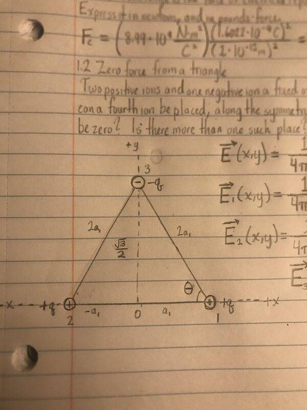

First I'll show you the picture I drew so you can follow the steps I took and make corrections along the way
What I wrote was:
$$\vec{E}(x,y)=\frac{1}{4\pi \varepsilon _0}\sum_{j=1}^{N}\frac{q_j\hat{r}_{oj}}{r^{2}_{oj}}$$
$$\vec{E}_1(x,y)=\frac{1}{4\pi \varepsilon _0} \frac{q_1\left \langle -a_1,2a_1cos\theta \right \rangle}{(\sqrt{(a_1)^2+(2a_1cos\theta )^2})^2}$$$$\vec{E}_2(x,y)=\frac{1}{4\pi \varepsilon _0} \frac{q_2\left \langle a_1,2a_1cos\theta \right \rangle}{(\sqrt{(a_1)^2+(2a_1cos\theta )^2})^2}$$$$\vec{E}_3(x,y)=\frac{1}{4\pi \varepsilon _0} \frac{-q_3\left \langle 0,\frac{\sqrt{3}}{2}-2a_1cos\theta \right \rangle}{(\sqrt{(\frac{\sqrt{3}}{2}-2a_1cos\theta )^2})^2}$$
Where ##2a_1cos \theta=y##.
You can simplify the algebra by just taking the triangle to have side length 2.
The generic equation is right , but note the numerator has ##\hat r##. In your later equations you have treated it as ##\vec r##.
I don't understand those later equations though. On the left you have the field as a function of x and y, but neither appears in the right. At what point do you think you are calculating the fields?
Anyway, you don't care about the x component. At points on the y-axis those will cancel.
Pick a point at (0,y) and write the expressions for the three ##E_y## fields as scalars.

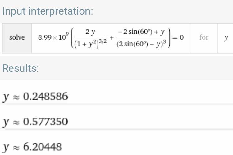

After taking your advice to simplify the algebra some, I set up the values such that ##q_1=q_2=1C## , ##q_3=-1C##, ##a_1=1m##, and ##k_e=8.99\cdot 10^9\frac{N\cdot m^2}{C^2}##.
Doing that and removing the units, I got the equation
$$\:\left(8.99\cdot \:10^9\right)\left(\frac{2y}{\left(1+y^2\right)^{\frac{3}{2}}}+\frac{-2sin\left(60^{\circ }\right)+y}{\left(2sin\left(60^{\circ }\right)-y\right)^3}\right)=0$$
I put this into Wolfram Alpha's solver and got the following:
However, I looked on Slader to see if someone else got this solution, and I saw this:
https://www.slader.com/discussion/question/two-positive-ions-and-one-negative-ion-are-fixed-at-the-vertices-of/
I'm not sure who's right. We got one shared value.

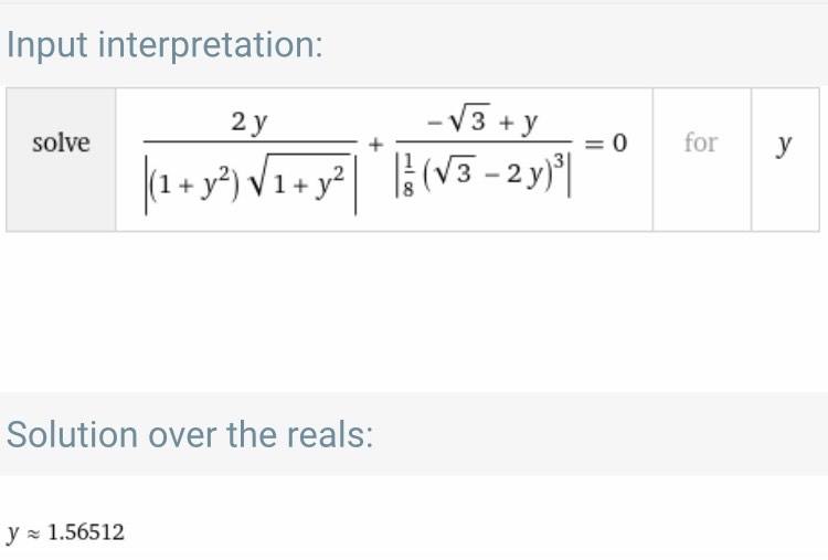

You have the power 3/2 in one denominator but you forgot the /2 in the other.
Edit: scratch that.. just realized you removed a power of 2,
Also, just occurred to me that you need to take the absolute values in the denominators.
##4y^2(y-\sqrt 3)^6=(y-\sqrt 3)^2(1+y^2)^3##.
You don't need the constant factor out the front.

So should I take the absolute value of the denominators in this equation? I expanded the expressions out and put ##\frac{\sqrt{3}}{2}## for sin(60):
$$\frac{2y}{\sqrt{1+y^2}(1+y^2)}+\frac{-\sqrt{3}+y}{\frac{(\sqrt{3}-2y)^3}{8}}$$
Yes.
I think your expressions are not completely correct. One thought I had is that you start over, and write the distance to the center one in much simpler form, and simply write the cosines for the other two charges in terms of ##y ##. You should be able to write a single expression that then needs to be solved for ## y ##, or actually more precisely as a function of ## u=y/h ##, where ## h ## is the altitude of the triangle. Perhaps @haruspex might have a different opinion, but that is my input.

One thing that is confusing is where the origin is for the distance ## y ##. The OP might be using the base of the triangle=in my post 22, perhaps that is why my expressions are different.
Edit: In the latest post, I think the OP needs to be consistent with his triangle=if you use ## 1 ## for the distance of half the base, then the altitude is ## \sqrt{3} ##.
I was using the base of the triangle as the origin.

I can't see where I was inconsistent with the triangle.
If the triangle is equilateral, and I set half the length of it equal to 1, then the length of the y-axis is 2(1)sin(60). This is the square root of 3.
I'm starting to get really confused now. The solutions to the following equation:
$$(\frac{2y}{(1+y^{2})^{\frac{3}{2}}}+\frac{-2sin(60^{\circ})+y}{(2sin(60^{\circ})-y)^{3}})=0$$
It occurred to me to just play around with it, and I got the following solution to the following equation:
$$-\frac{2y}{\left(1+y^2\right)^{\frac{3}{2}}}=\frac{-2sin\left(60\right)+y}{\left(y-2sin\left(60\right)\right)^3}$$
y≈−0.14629…
This value is the negative value of what the guy in Slader got. Is this a coincidence?
The top part of 29 is good. I agree with 6.20 as the answer. The other solutions are meaningless. To get the other point, it is going to be slightly below the base. You are going to need to write new expressions with the new scenario to find this other point.
